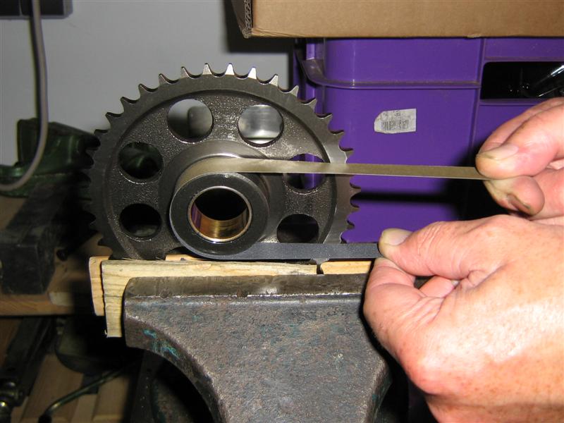

You can try to a light wet (oil) sanding of the surface to re-new the grip. Start with 180, finish with 600
www.z750twin.de/anlasserfreilauf.htm
