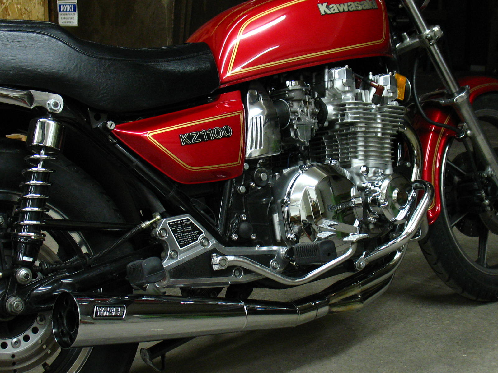

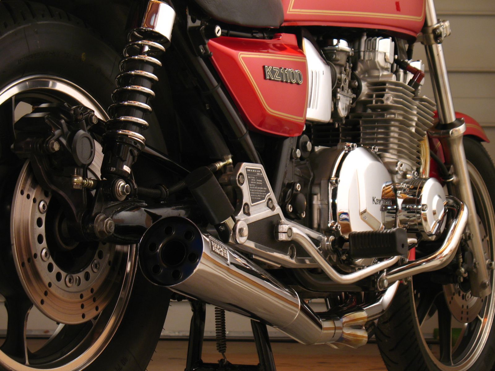

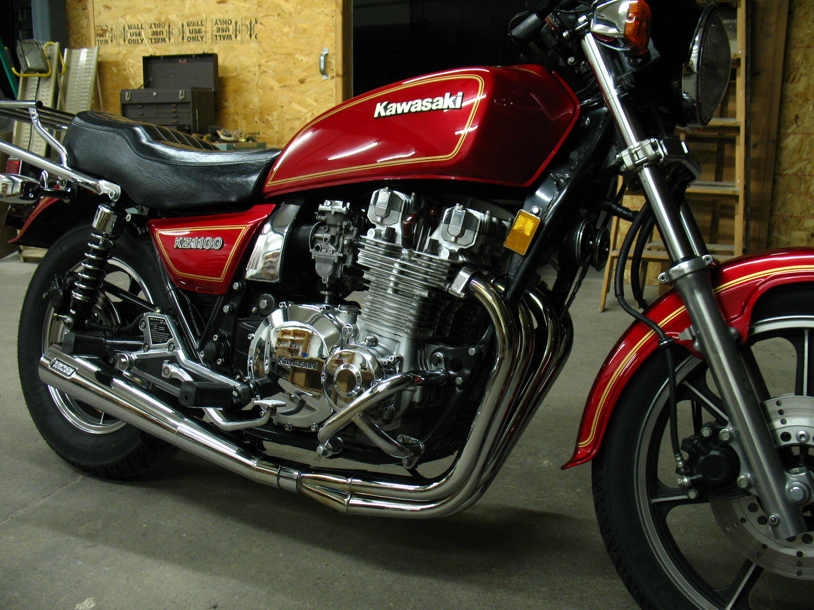

V&H tech said "forget it", but considering the J-model 1000 and 1100 engine and frame-cradle are essentially the same, I opted for the V&H 13009-J regardless.

03 May 2015 11:59The Pro Pipe/drag model is the only header V&H has available for the KZ1100A. I prefer leaning into right turns which could be problematic with that one. Other than the Mac, the options for my bike are basically none.swest wrote: Why did they say forget it? Your stinger is lower than mine, is that it?
Regarding my stinger...I don't know.

03 May 2015 12:15 - 04 May 2015 19:19I believe that model was designed specifically for the 1982 KZ1000-JDale5256 wrote: Do u think the 13009-J will fit the 1982 LTD 1000
You may have to take the chance and modify something to make it work on your bike. In my case, the rear foot-rest bracket is longer than the KZ1000-J, requiring a spacer on the collector flange, and the megaphone mounting tab needed to be tweaked to align properly. The megaphone slips over the header by only 5/8", but it works very well...oil/filter changes are a breeze, and the center-stand comes in handy more often than not. The baffle options V&H has available for this header make a typical Harley sound like crap.
