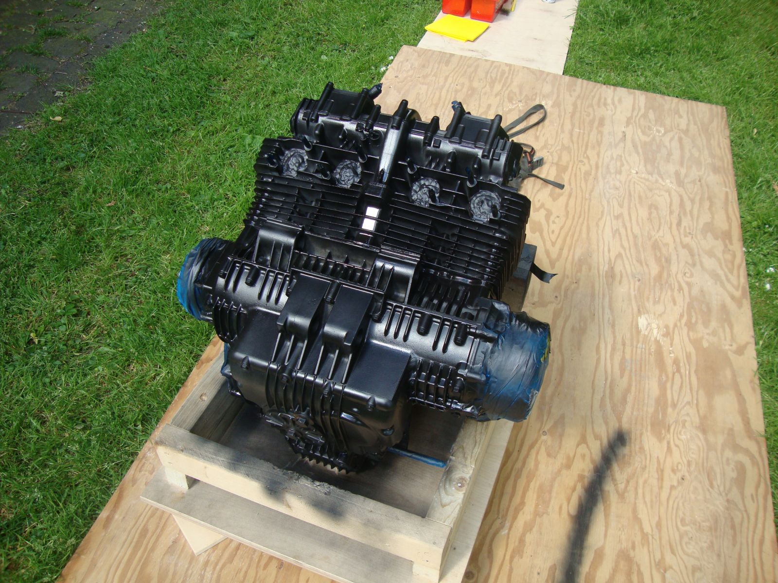

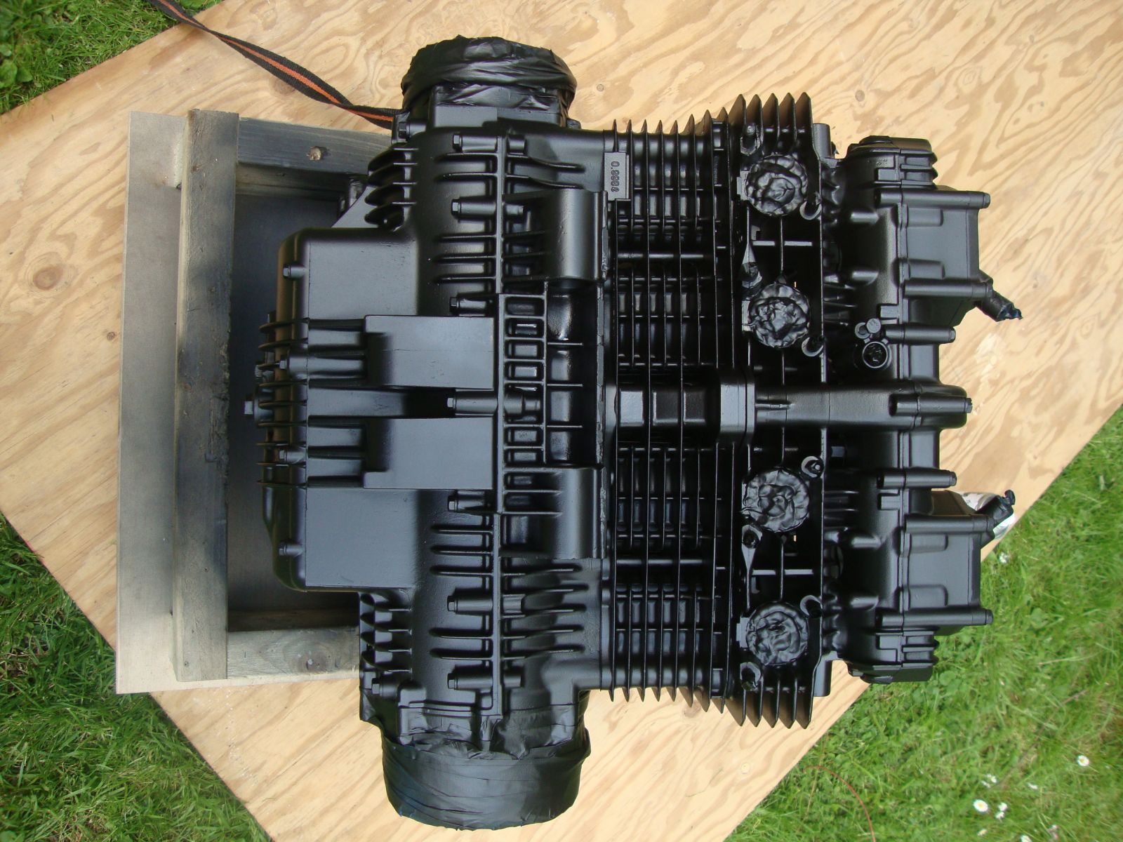

I used PJ1 Satin black on mine. First I washed it ,then degreased it then I washed it again with a power hose,( clean,clean,clean)blew it dry with an air line ,masked it up and sprayed it.
It came up fantastic.
The paint is meant to cure from the engine heat,from running. Mine isnt running yet,it isnt even in the frame yet.Until then,it is vulnerable to fuel spills etc,so Im being very careful.
Anyway,Im very happy with how it turned out though I cant say one way or t'other about its longevity.
One thing to keep in mind with yours. If the alloy is damaged, ust painting it wont fix it .Itll look just as damaged,only in black.
You need to sand back as much of the corrosion as you can first. Make it look as good as you can, Clean the hell out of it,Then paint it.
As with all painting jobs, Its all in the preperation.
Good luck

+100 on the PJ1. I am spraying my engine right now but I did my valve cover a year or so ago. It still looks great!
I used the PJ1 Special Black Finish G. It's a porcelain paint.
Here is a pic of it going into my "paint oven" LOL
