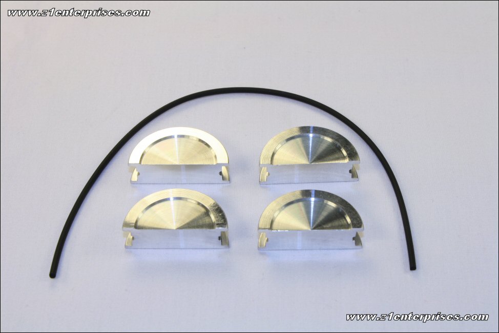

What do people think of this process?
Has anyone ever tied this specific process before and had success?
"Then I figured out what worked for this motor. Here’s what did the trick:
With the cam cover off and the caps removed, clean the surfaces of the end caps as well as the part of the head where the caps are inserted. Use acetone and wear a glove and eye protection so you don’t get hurt. This will remove pretty much all of the oil residue.
Apply Permatex Ultra Black in a thick bead onto each cam end cap. Spread the Permatex with a small flat bladed screwdriver or something similar. Install the caps onto the head. Wipe away the excess.
Install the cam cover (no gasket) and screw the bolts in finger tight.
Let the motor sit for at least 24 hours so that the Permatex will dry thoroughly. Is it really necessary to wait 24 hours? I’m not sure, but it worked for me.
Remove the cam cover, install the gasket and then reinstall the cover. This time tighten up the cover as you normally would.
Note: I did not use the viton rubber sealing material that came with the caps. Permatex Ultra Black was all that was needed to seal it up. "

For my current project, I bought a newer style aluminum plug with a groove and o-ring type seal. I don't know of anybody that has tried them yet, but I hope to within a couple of months.

I just got them as well.
Those are the same ones used in the procedure I mentioned above.

01 Apr 2015 03:31Two questions-nickleo373 wrote: I used hondabond instead of permatex and let the valve cover sit without the gasket for a day. Put it all back together and there aren't any leaks
1. Did you use the the original rubber plugs or the billet ones (when you used the hondabond)?
2. If the billet ones were used- did you use the Hondabond in conjunction with the rubber O-ring material? Or without it?

01 Apr 2015 10:42 - 01 Apr 2015 10:43KzChop82 wrote: I just got them as well.
You added permatex over the o-ring material? I'm thinking those should seal themselves. Otherwise, you can buy plain aluminum plugs without the o-ring groove.
Have you tried them without sealer on the o-ring side?

01 Apr 2015 14:04Steve,swest wrote: I reused my rubber ones for 10 years. When they started leaking I'd use RTV. I put in new ones with no sealer and they lasted until I got my billet ones.
What's your process for using the billet ones? Do you use the o ring material and a sealant? Or just one of the two?
