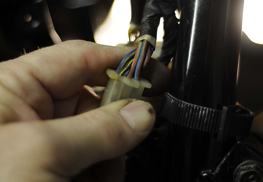

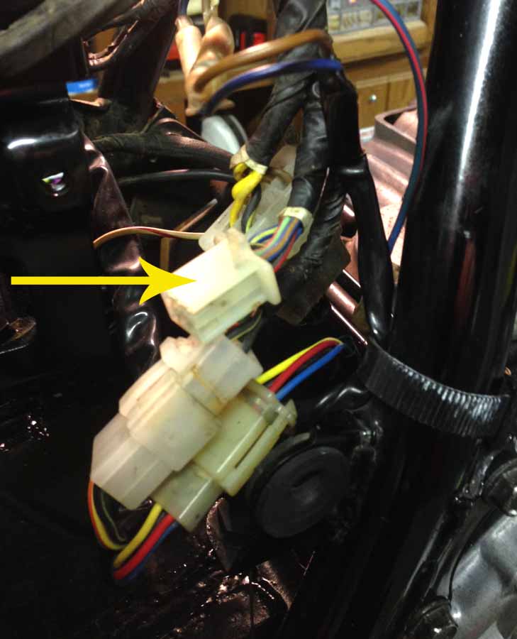

First, what does the indicated elec connection connect to? I have no more elec parts in the box. Suggestions? It's a six lead connection. Cannot figure it out.

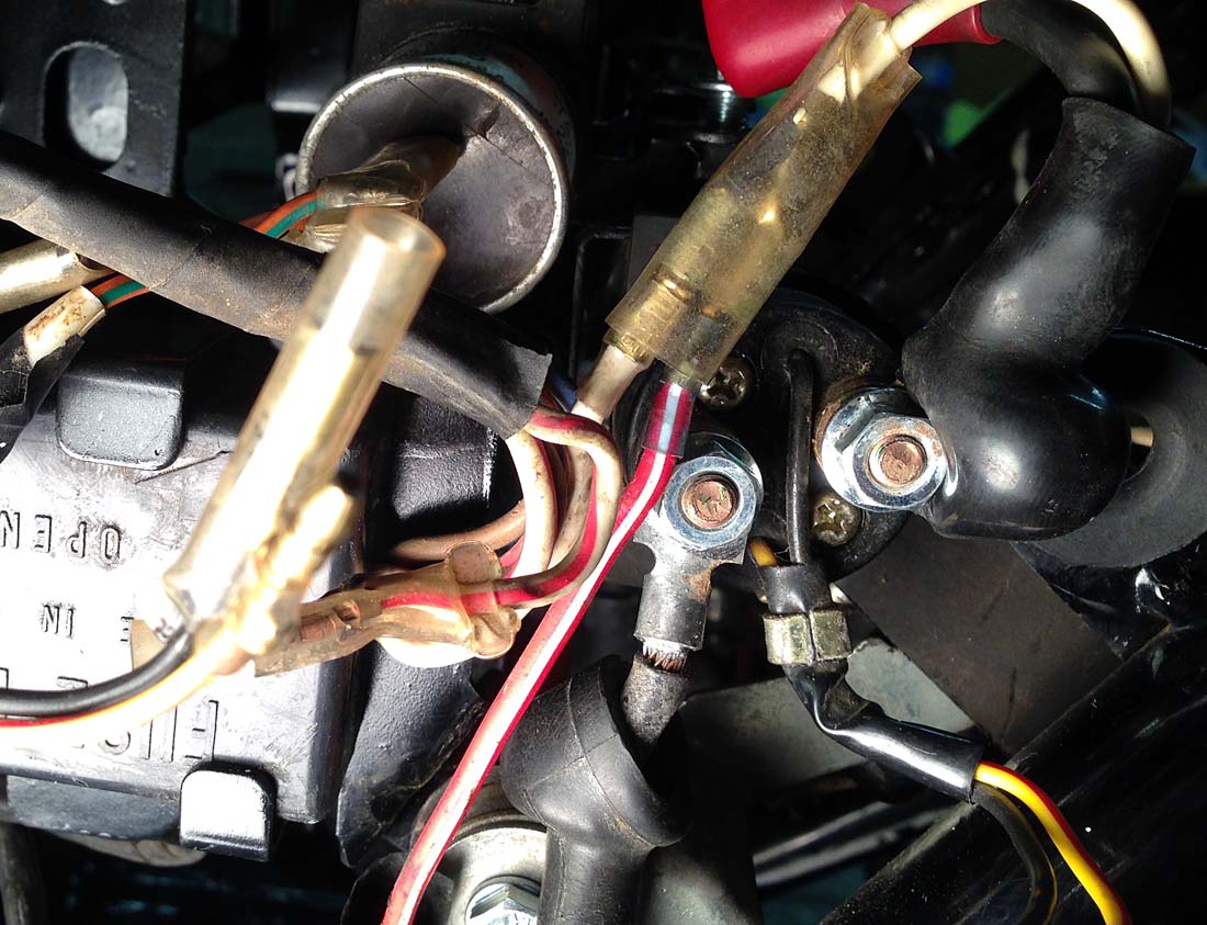

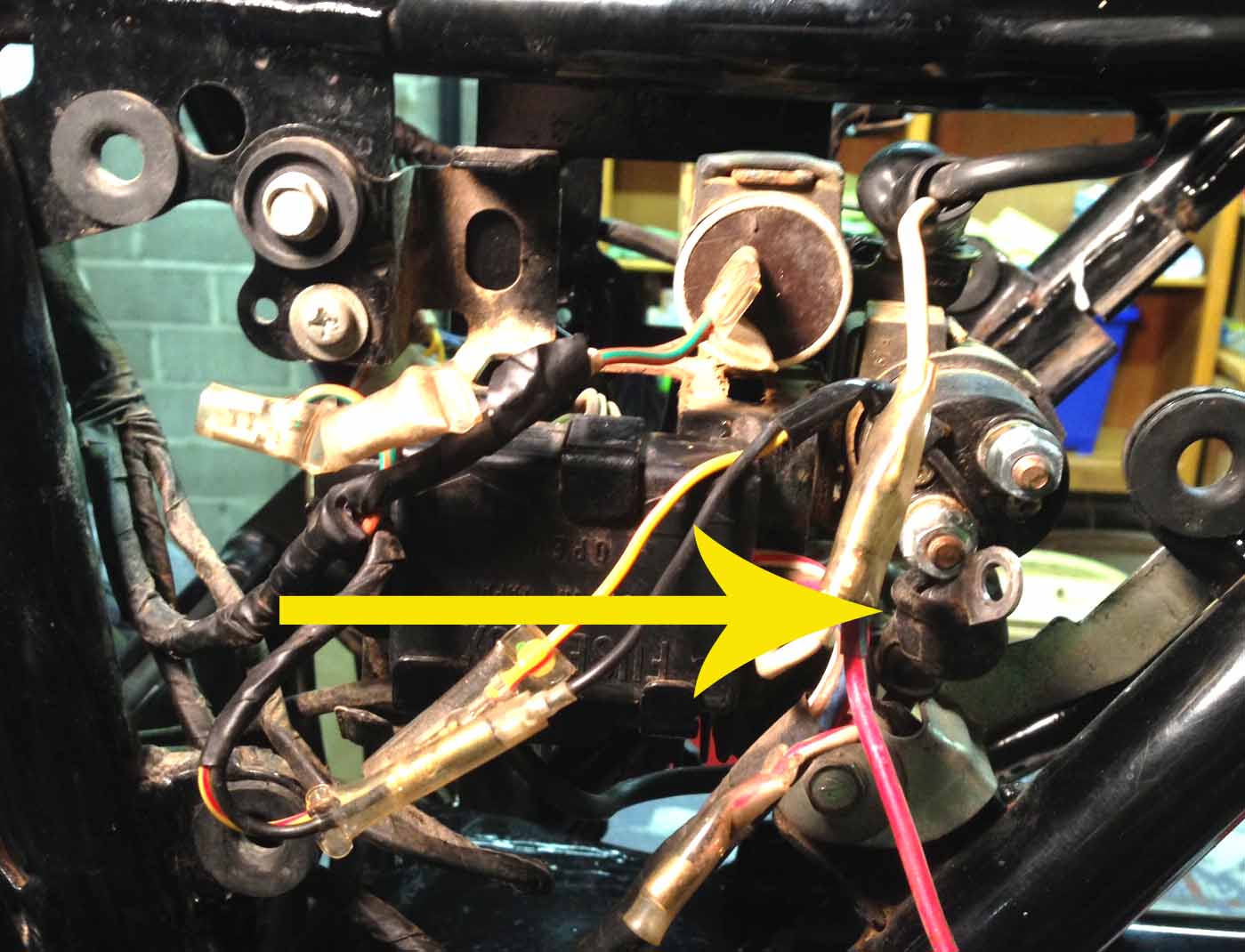

Next, where does this (arrow) lower ground bolt on??

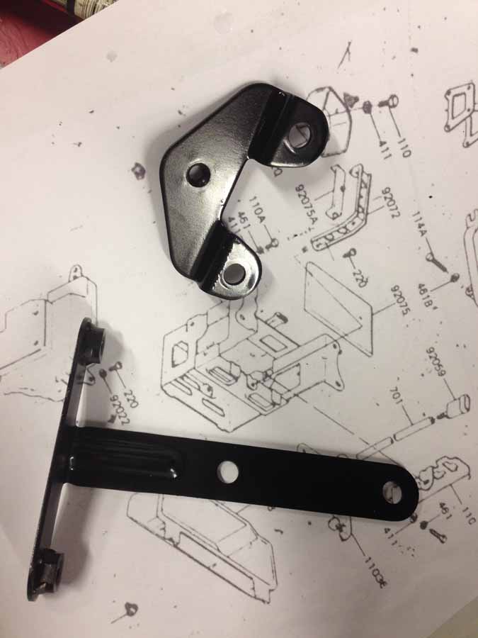

Up next, these parts do not seem to be part of the 1983 KZ750 battery box assembly, correct?

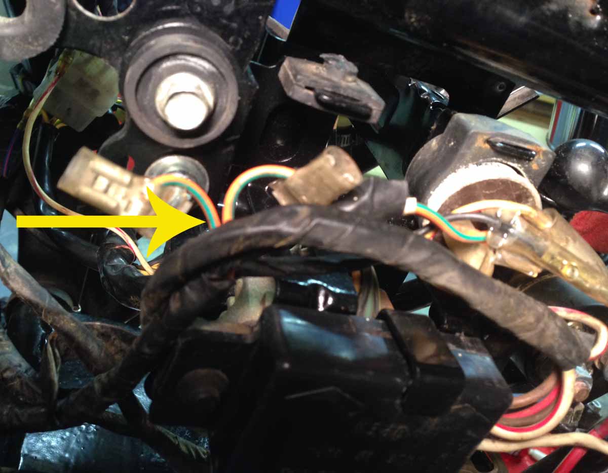

Finally, what connects to these tiny leads on the LHS of the battery box? They have kind of a curved connection.

Maybe the reserve lighting device plugs into that connector? What are the wire colors?
Starter motor/solenoid wire? Connects to starter solenoid there right behind it?
Brackets --- don't know? For the horns or some other electrical device?
The little flag connectors maybe connect to either the turn signal relay or hazard relay? little cylindrical cans --- one visible in right side of photo

1) Not sure is it off the main loom? what are the wire colours?
2) That is your battery lives : one from the battery + to solenoid relay (the cylindrical bit with two thin and two fat leads) and from the soleniod to the starter motor terminal, on the starter motor body.
Solenoid relay uses the two little starter button wires to switch a heavy duty contactor joined by the fat battery leads.
Your battery - ve terminal also uses a thick lead bolted onto the engine, that is the ground.
3) Don't recognise those parts
4) hazard warning relay, two orange/green wires. Like your indicator flasher unit.

Hi
Thanks for the help.
Now I have the two leads going to the solenoid. The positive (red cable to battery) is on the right and the black goes to the ground under the starter is on the left. Hopefully that is correct?
Also, better picture of the connection missing a connection. I think it is the reserve lighting unit. I've ordered one.

...goes to the starter motor POSITIVE terminal, only one live battery connection through the solenoid relay as it the starter grounded to the engine anyway.
Yes, it is the reserve lighting block connector, we didn't get those on the euro models.
