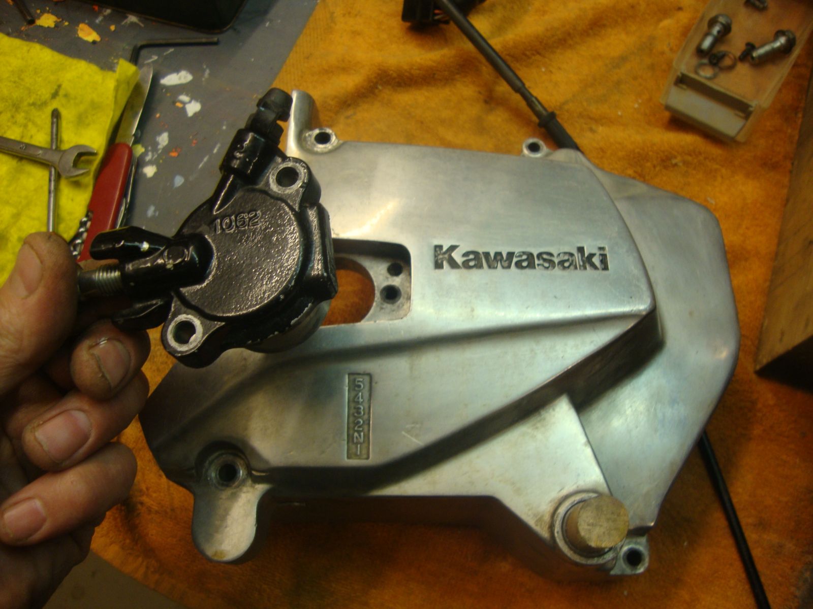

Does anyone know if its possible to mate these together or do I need to buy a D&G Plate or some such??
Engine is a 1000CSR and clutch pump is ZX9R

Similar conversions have been done, dont remember what slave was used but someone has clearanced the stock cover to clear a hydraulic slave before, and fit it, quite well, underneath where it wasnt obvious.

I did a conversion about 8 years ago on my '78 1000. I clearanced the back of the stock cover, had to elongate the mounting holes slightlyn and trim the push rod down a bit, but it works fine.
