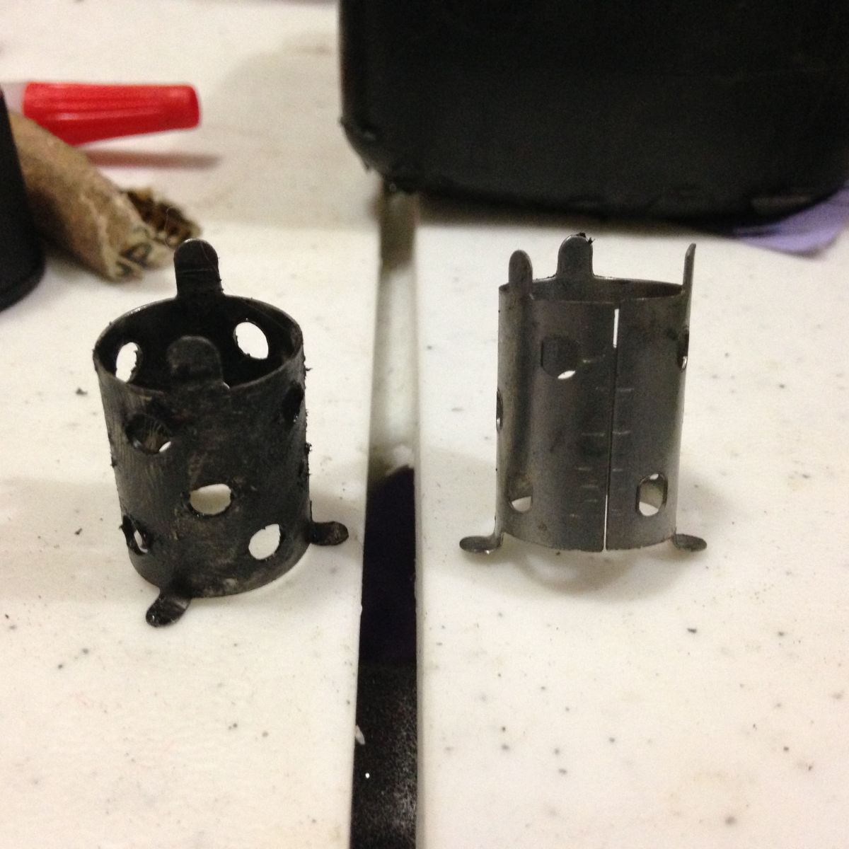

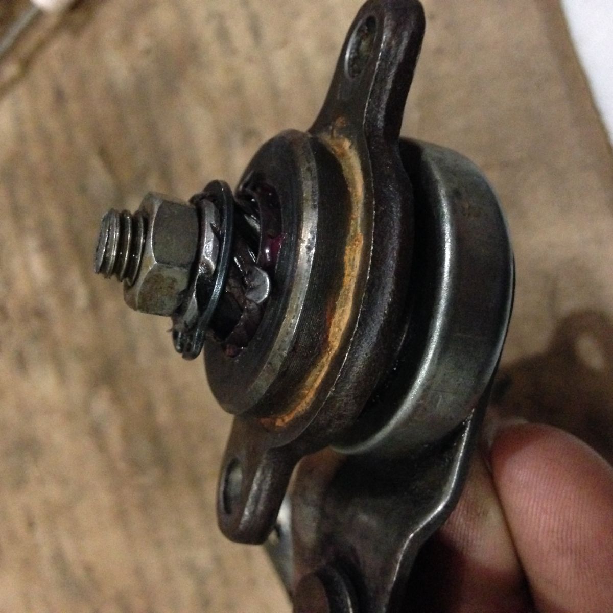

So after 300 miles on the 79kz1000...clutch started to act up. Hard ti disengage and ingage.
So having a extra cable from my 77 project i switch it out and got a little better but still not right.
I then took the Acuator from my 77kz1000 and fix the problem.
Did look for a new / used on but found all to be expensive.
I found a new ball bearing sleeve for $15 ship.
Left one worn out and right new one
And the Actuator rebuilt.
Works like new
