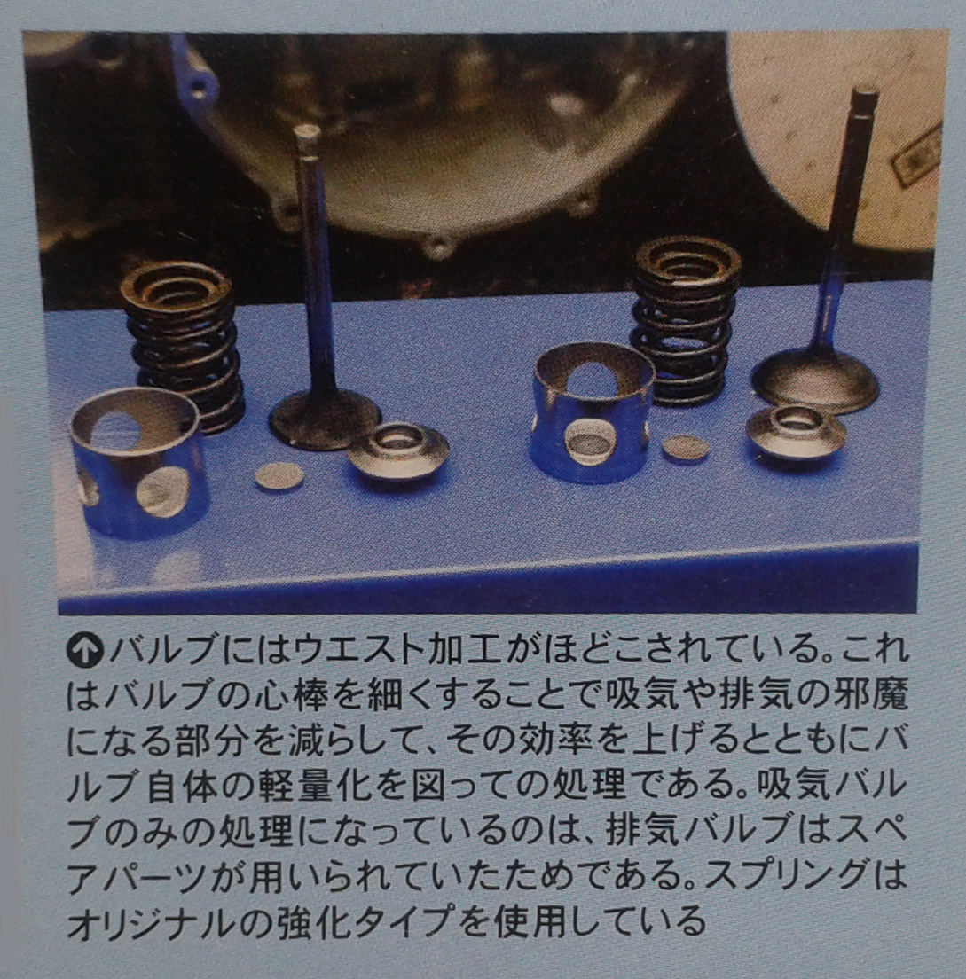

Finally found this image from an older Japanese speed magazine.........shows how Sanctuary does it. The holes they drill are pretty huge compared to the RC ones. These ones look like they are shim under buckets, wonder if it makes any difference. Can anyone translate the text please?

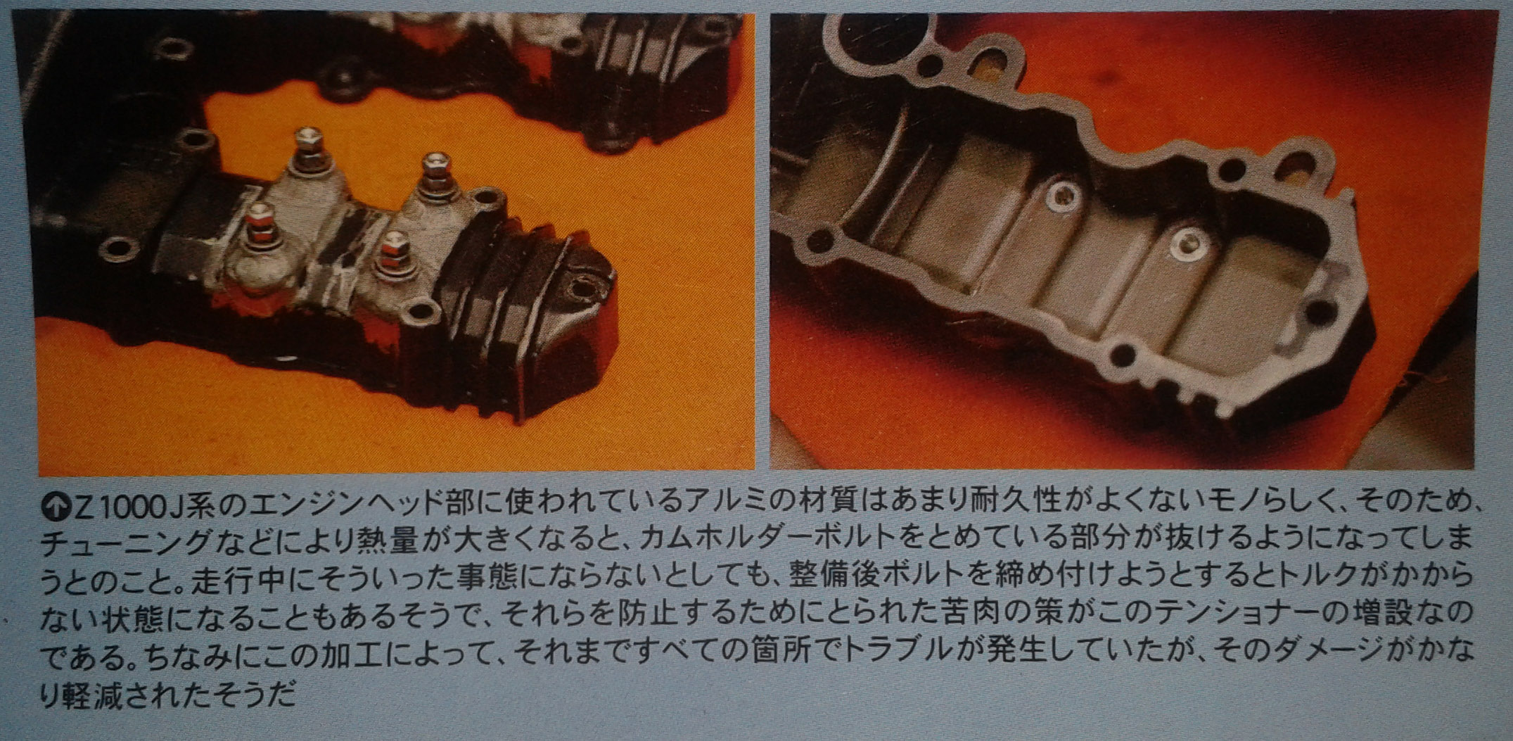

This image was also on the same page and I am wondering what is going on here with the extended bolts on the valve cover.......again if anyone can translate it might help
79 KZ 1000 LTD

Wow! I have never seen a valve cover modified to be a cam girdle before......but I have never been to Japan. Must be an endurance racing mod?
I think the biggest weight savings for the shim under set up is getting rid of the weight of the shim over size shim.
