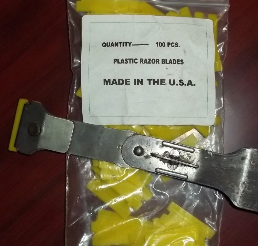

Were you Guy's been?
Plastic Razor Blades!
10's of uses around the shop and house, painting, detailing.
From my chemical Guy "wellworthproducts" .com
