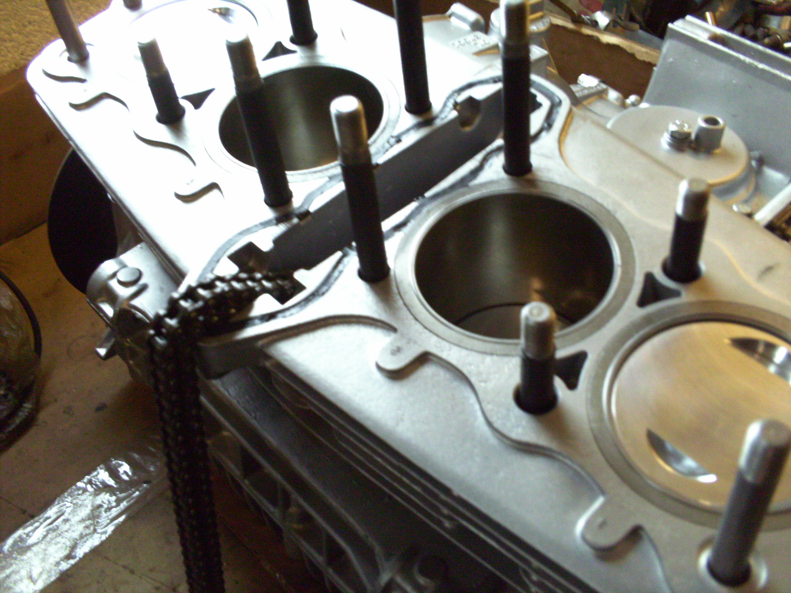

Re: Split head gasket vs. a 1 pc. gasket
12 Apr 2015 02:13 - 12 Apr 2015 02:17Only know if you pull the head and gaskets to see if there is a larger diameter groove in the cylinder block, between the 2 and 3 piston where the O ring would go.elkbuster wrote:PLUMMEN wrote: The copper gaskets are made to be used with o ringed cylinders,theyll leak like a sieve other wise.
I definitely prefer the 1 piece.
How do you know if you have an O-ring cylinder?
I am trying the one piece this time myself. After a few of these O rings and leaks after a few thousand miles, I'm going to go the other way now.
12 Apr 2015 04:18 - 12 Apr 2015 04:23elkbuster wrote:PLUMMEN wrote: The copper gaskets are made to be used with o ringed cylinders,theyll leak like a sieve other wise.
'O' ringing - Commonly known as PIANO WIRING. a shallow groove is machined in to each liner top into which a thin wire is pressed
This wire is left proud of the surface so that it bites in to the copper gasket to create a superior seal.
See the attached pic .
