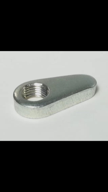

Here's the nut that is being talked about. If I am remembering correctly it's used on the bottom righ side of the engine under the ignition cover.

One each side on the bottom mounts.
