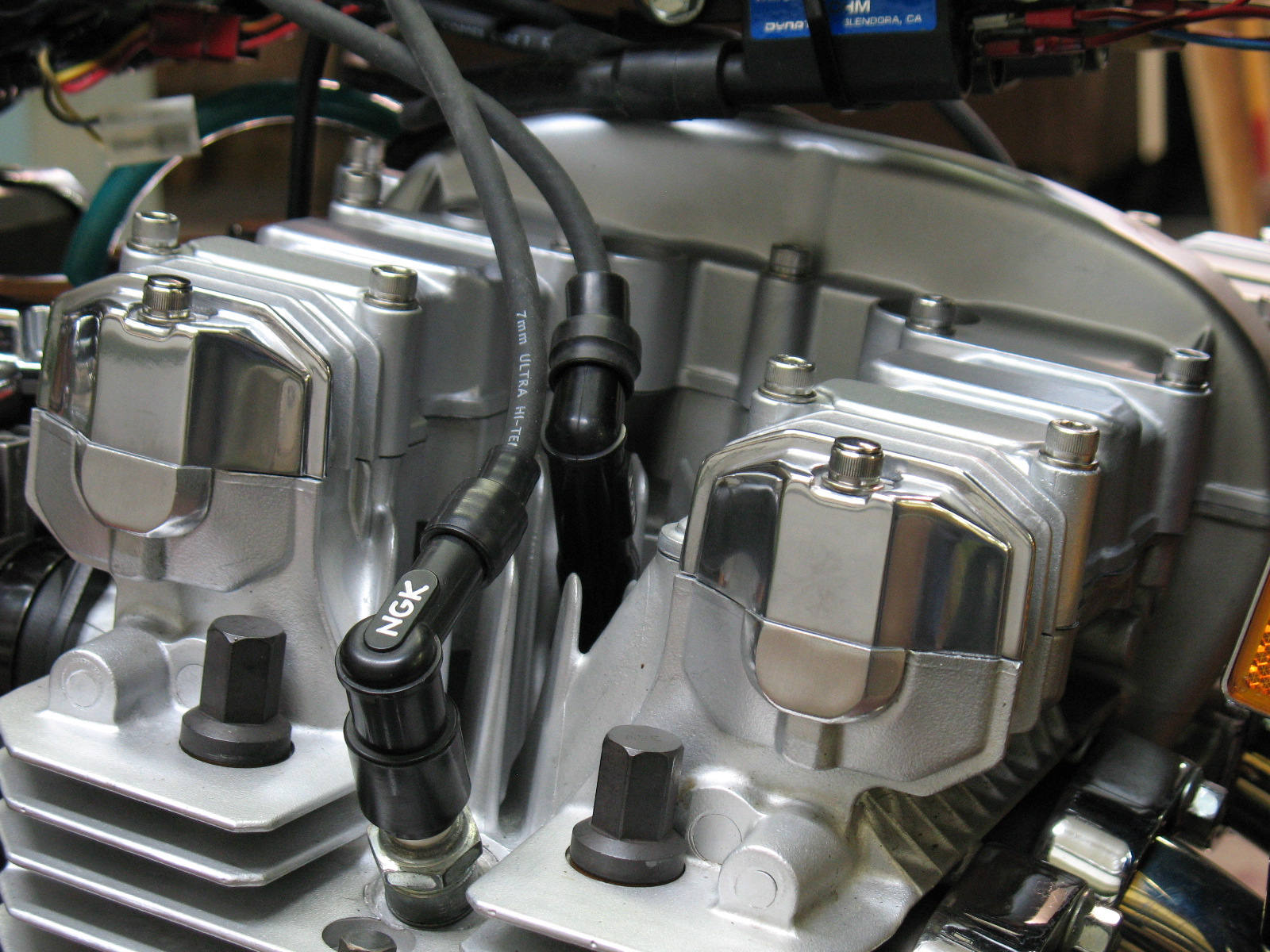

- ezrider714
- Posts: 256
- Thanks: 38
Re: Attn: Cylinder Head Guru's
19 Jan 2015 19:42 - 19 Jan 2015 19:44
Sweet looking motor DAVEO Thumbs Up on the SHCS they highly contribute to the look, and they are never a hassle when wrenching on the bike....
