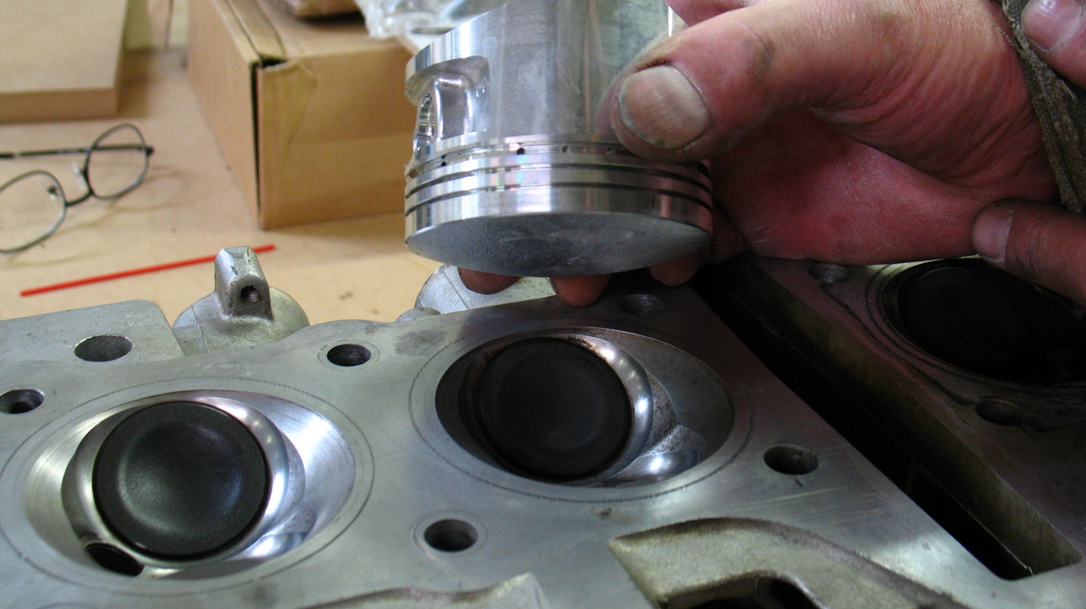

The engine is a 1982 KZ1100-A2 with stock J pistons.
This beauty has shim over buckets with standard J cams.
I was hoping for a simple, straight forward head-swap...now
OE Standard piston I want to use...if possible.
You need to dry build and cam time the top end with the cams you intend to use.
you can just fit one bare piston, no rings or circlips. then rotate the engine slowly while observing the valve movement through the plug hole and their proximity to the piston crown.
If there is no contact you then need some plasticine placed under the valve head which will get compressed and you take a measurement off that to see how close things are and then you can decide which approach to take.
If using stock pistons you may just bolt the head on with no problems but a higher crowned Wiseco piston etc may need the valve pockets re-angling or fit a piston intended for the model the head came off.

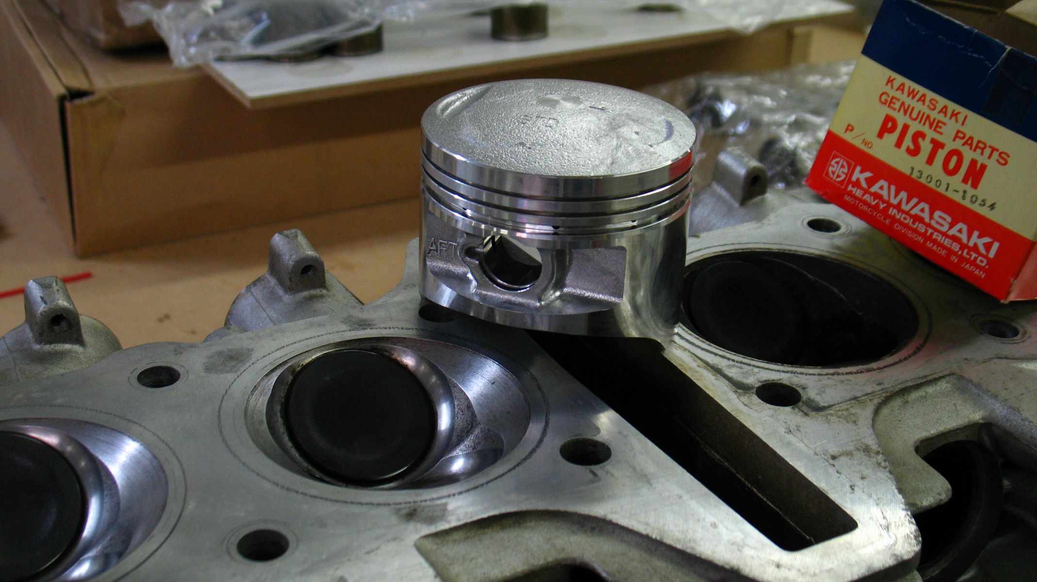

So I may be ok with the stock pistons? That would be just the ticket for me. Notice in the photo how the stock piston dome is bathing (completely submerged) in the tub, without a head-gasket. That's a good sign, isn't it
How about this? If I carefully mount this head on the block after removing the existing 82 J-head from the motor, and lightly fasten it down on top of the old head gaskets...then carefully attempt to install the cams per shop manual directions. If they bolt in without getting held up by a valve, I'll be good to go on to the "look through the spark-plug hole" idea. :whistle:

You won't have any clearance issues with the piston crown and combustion chamber even if you assembled with no head gasket.
The GPZ pistons had a higher dome than yours anyhow.
It's just the valve angle and larger valve heads that need to be watched.
Your plan to switch heads and drop in the cams is as I suggested and you will probably be good to go and you get a slight compression increase for free in the deal.
With the valve angle being steeper ( more vertical ) this tips the edge of valves further away from the pistons edge but brings them closer at the crown.
Using the std piston with relatively low dome there will probably be plenty of clearance I would guess.
I have only ever built performance motors using these heads with either turbo or hi comp pistons and never just swapped the head on a std 'J' so can't say for certain.
Maybe Larry or someone else here has just done the basic head swap and can confirm that no further mods were needed.

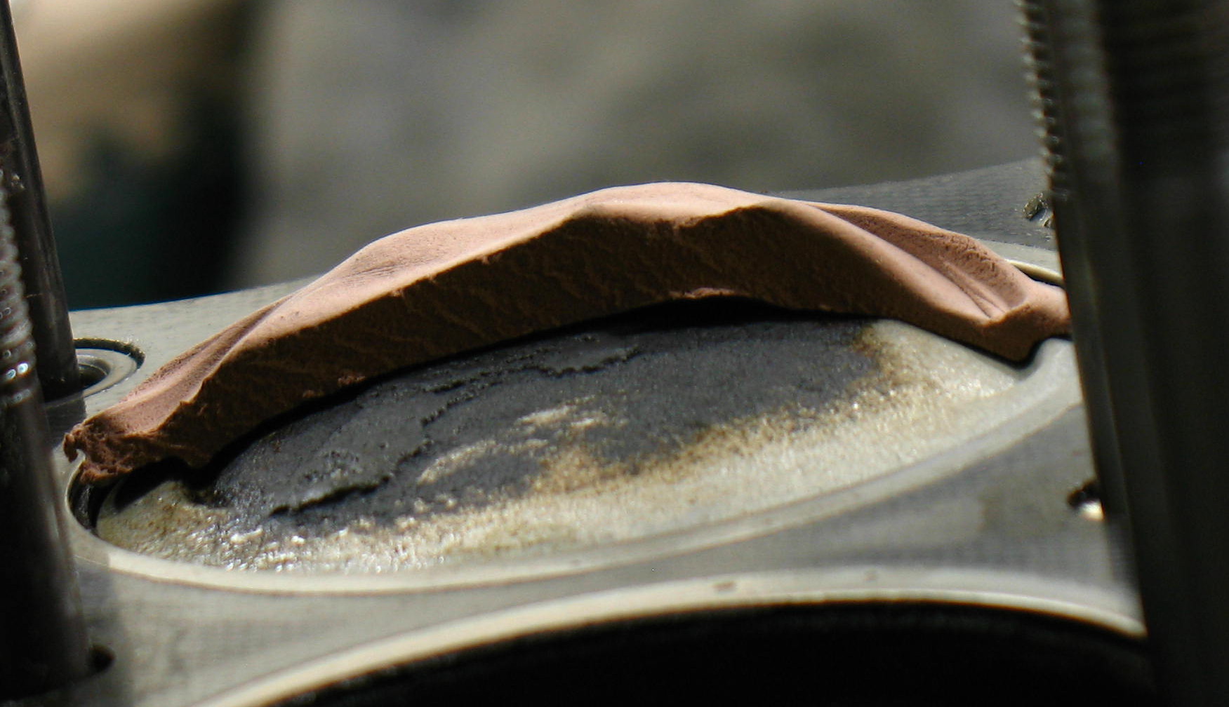

Re: What's it worth, and can I run it on my engine?
13 Feb 2015 08:54 - 15 Mar 2015 08:42daveo wrote: :whistle: :huh:...
Decisions, decisions...

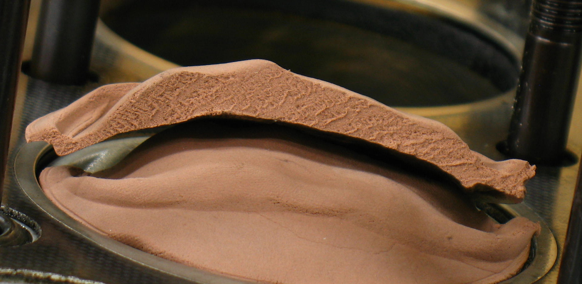

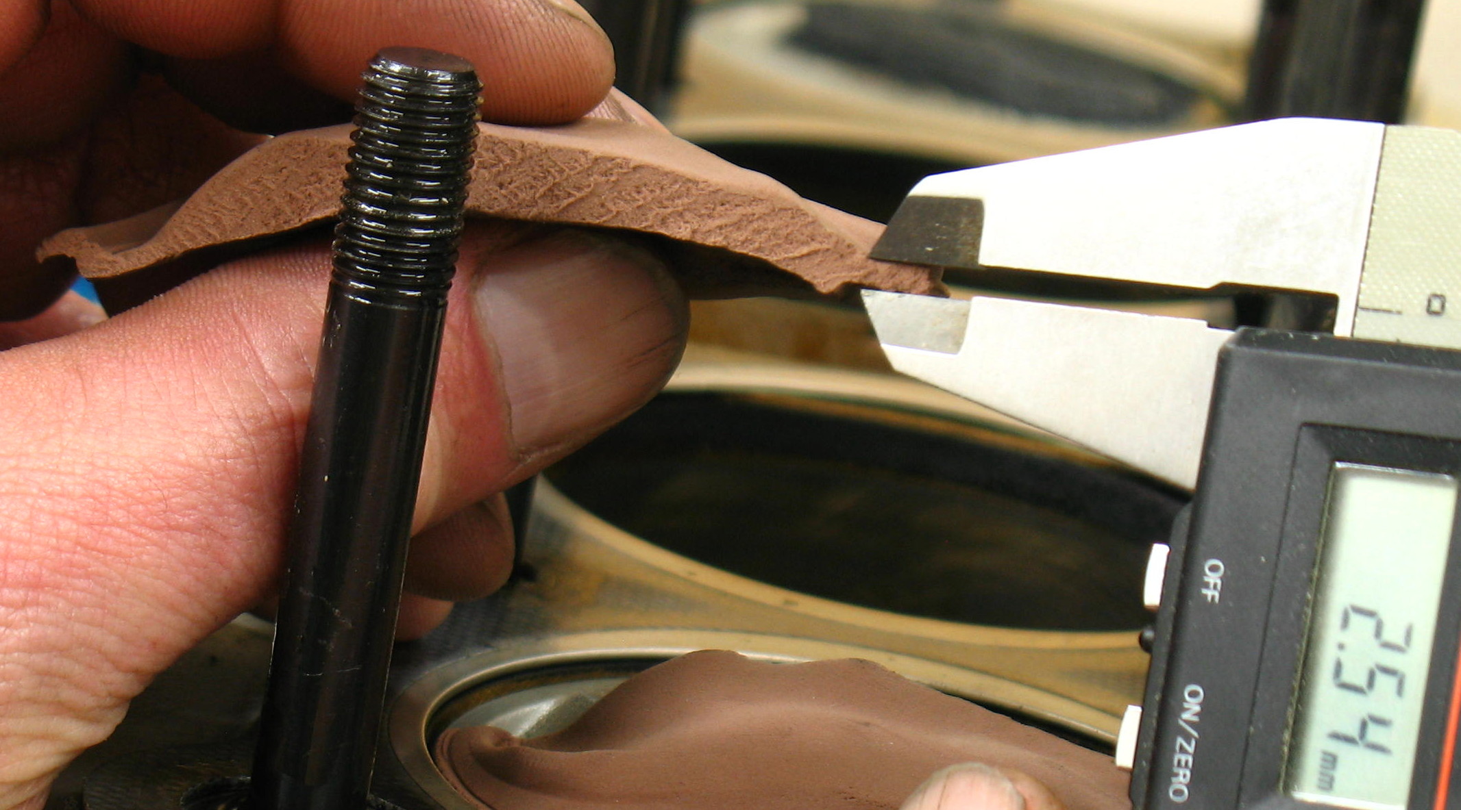

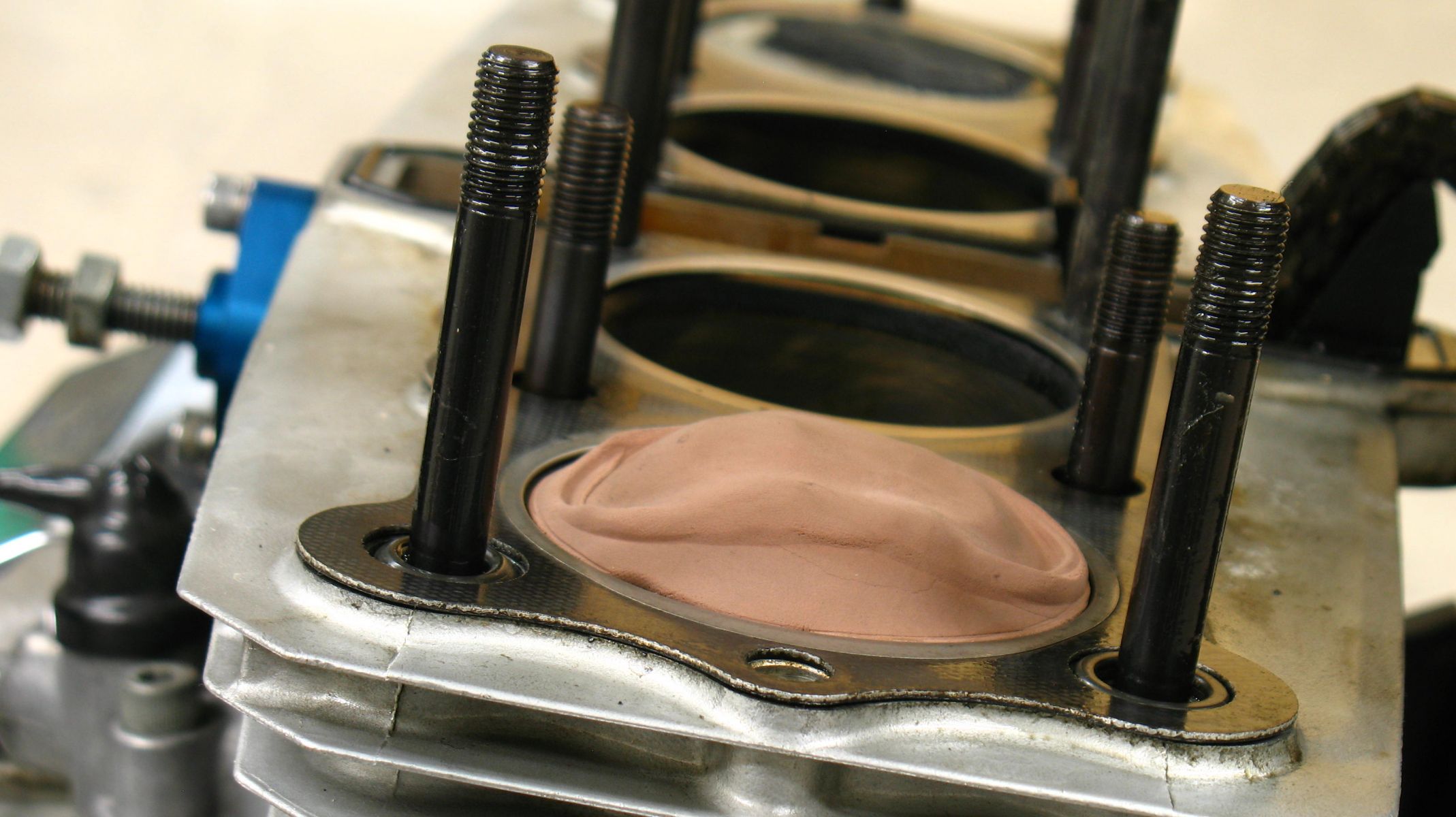

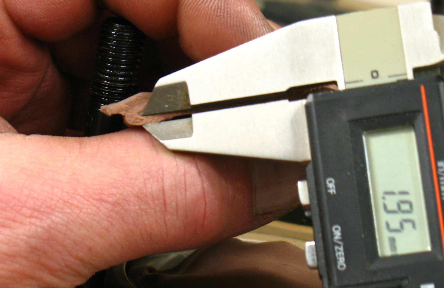

With 1984 GPZ cams and sprockets, I clayed the unmodified stock piston and got this:
First time for everything. Nothing ventured...(definitely) nothing gained!
1982 KZ1100-A2/1170cc sleeper 😀
