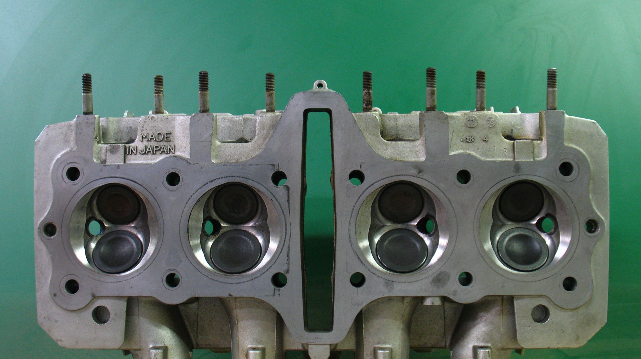

Removed from a 1984 ZN1100-B1 LTD with 8,800 miles
Opinions requested, please... :whistle:
After mineral spirit cleanup...

Which engine do you want to fit it on.
One of the best heads to have for performance modding.
Bathtub/twin swirl head.
Same casting as GPZ Unitrack but probably shim over bucket instead of under.
Lower compression than earlier KZ9/1000 heads but slightly higher comp than the earlier twin shock GPZ and J heads.
Has steeper valve angle which allowed the larger valves to be used.
Be careful with piston to valve head clearances on assembly.
Depending on application you may need to fit different pistons or machine the valve pocket angle to avoid collision etc.

The engine is a 1982 KZ1100-A2 with stock J pistons.
This beauty has shim over buckets with standard J cams.
I was hoping for a simple, straight forward head-swap...now
OE Standard piston I want to use...if possible.

If it were mine, and it's not, I'd take it to a shop and have the valve seals replaced, and the valve seats checked for wear / pitting, but other than that it looks nice. Since you have it off, it's much easier to do it now than wait 2000 miles and have blue smoke coming out of it

Someone off-site suggested that this head would work without issues, without having to modify or change pistons...and that I could install a set of 84 GPZ cams to take better advantage of the head design for increased performance.

This is the head that LarryC did for me for 77 KZ1000 project. mine flows over 100 cfm. best head you can use unless you go for an aftermarket head. we did valves and web cams on mine.its going to be a fun ride.

on my head we did 38.8 intakes 33 exhaust valves. titanium retainers with kibblewhite .500 springs, Viton seals, APE guides, and WebCams 122/125 grind cams. Larry did the port work. He is a genius!!!!!!!
