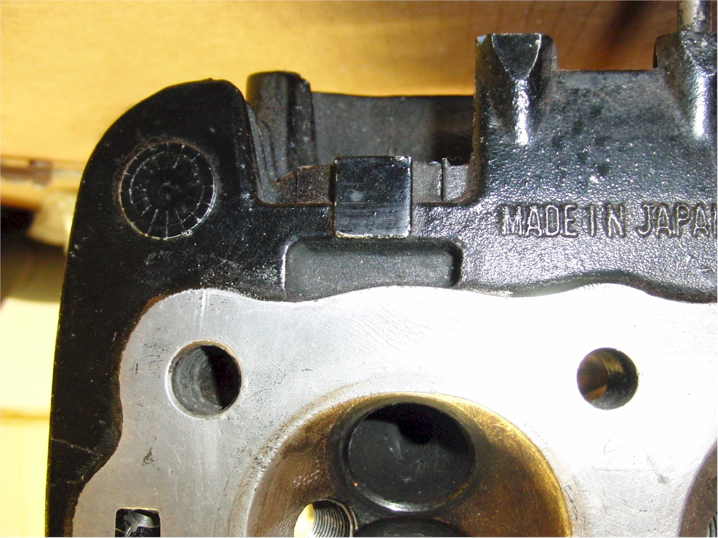

There are 2 small square flats about the size of a postage stamp cast on the cylinder head fin just past the gasket face below the exhaust valves. This skim marker allows a straight edge and feeler guage to test whether a head has been skimmed.
What is the measurement on an unskimmed head? I can't see any reference to this any factory manuals. I'm guessing this will be a standard figure for all kz bikes.

I am using sae feelers, so the metric increments are not even values.
On one head the fattest gauge that would slip in, without lifting the straight edge was 0.41 mm. This head is pretty clean, but was re-painted at some point, and is the one in the photos I'm including. I'm not certain what prep was done, and how thick the paint is, so it might not be representative of a factory-fresh head.
On another head, the fattest was 0.46mm, but this head was pretty dirty, and the paint was missing from the pads. The pads showed some corrosion, which I scraped off before measuring.
I believe these heads were never skimmed.
