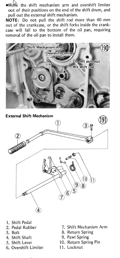

so, my chain broke about a week ago and took part of my engine with it, i am in the process of buying the parts i need to fix it, but i am having some problems getting the names of some of the parts required, i have a picture linked to show everyone what i need, if someone could help me out i would greatly appreciate it, thanks!
Its the black ring disc and the bent rod inside the mission cover i need to know about, i have everything else i know thats broken already purchased but i cant for the life of me find the name of these parts!

What kind of bike is it?
The rod is your clutch push rod.

The external shifter mechanism is under the broken side cover. here are a couple of pictures from the manual. You should et a factory manual, they are cheap on ebay.

01 Jan 2015 22:46 - 01 Jan 2015 22:48Bummer, hope it didn't take out any leg meat. If ever there was a picture proving why it makes sense to spend $90 on a quality chain, that's it.....suspectcobra wrote: so, my chain broke about a week ago and took part of my engine with it,
BTW, the pic you posted is rotated 90 degrees and had me scratching my head a while. I have ridden a 79 KZ750 B4 for 35 years now and I couldn't figure out what those things were either for a couple of minutes.... but I'm old and senile. :laugh:

Not too bad. Rotate the pic 90 Deg. The push rod you can buy or make, the cover you may have to buy new if not on eBay.
