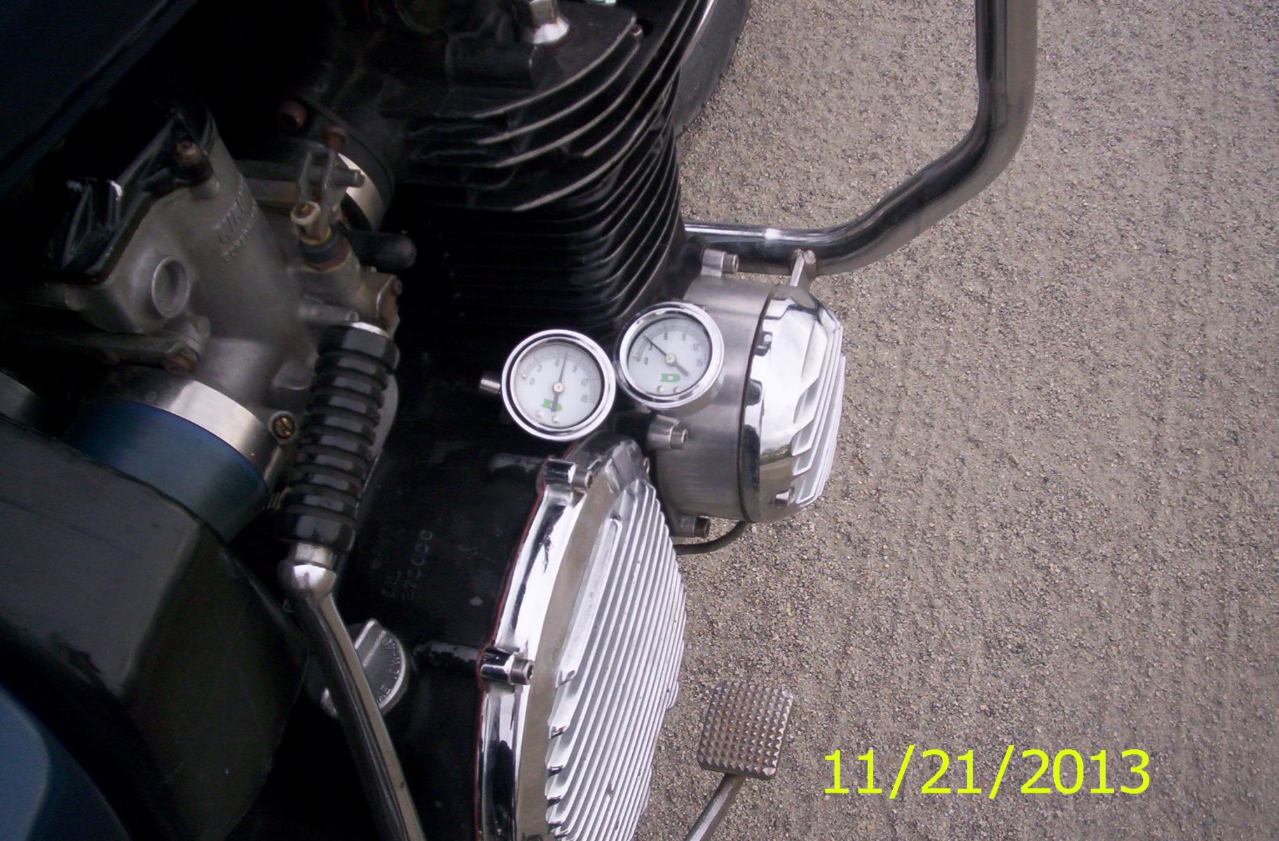

30 Dec 2014 06:27Attachment PICT0005.jpg not found
This is my gauge and it is on 0 when hot and on 9 when cold.

Your pic is a bit blurry but that gauge should be reading in PSI not Bar's if it's the same as mine.
9 psi is ok for cold but zero is not for hot.
However ! some of these aftermarket gauges aren't really that accurate though at low pressures if not a well know make and some are just more for show .
If it's a recent addition along with the rebuild I would have the pressure checked with a good quality gauge first before digging around inside the motor again.
The std oil pumps rarely give any trouble and the usual culprit is debris blocking up the gauze on the pick-up which is unlikely as you have had the bottom end apart and checked.

I went through my oil pump on my last build. #600 paper on a piece of glass switched gears and thinner gasket. I blew two Dorimi 30 PSI gauges right away. I contacted the seller and he sent me a new one. That was my 2 ND one. I would peg the gauge on rev. when cold. Finally ordered a 60 PSI gauge meant for a Sportster but no reading. It had a small jet in the opening. It was loose so I screwed it out. Would have fallen out in time. Got a reading and still do. OK. Same problem as you except the needle is just above 0 at idle. I'm convinced it's the oil it's self. Been using Castrol GTX 20/50 all my life on everything. After reading about the new oils how they're not the same, I'm thinking I should change which if hard for me. Same with my 69 F 250. Just put in STP and oil pressure is up 10 PSI.
