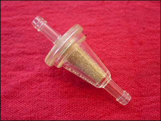

If not already done, would also install an aftermarket in-line fuel filter to help keep the recently cleaned carbs clean.

There are fuel filters on there now, i think there old though ill be getting new ones soon.
