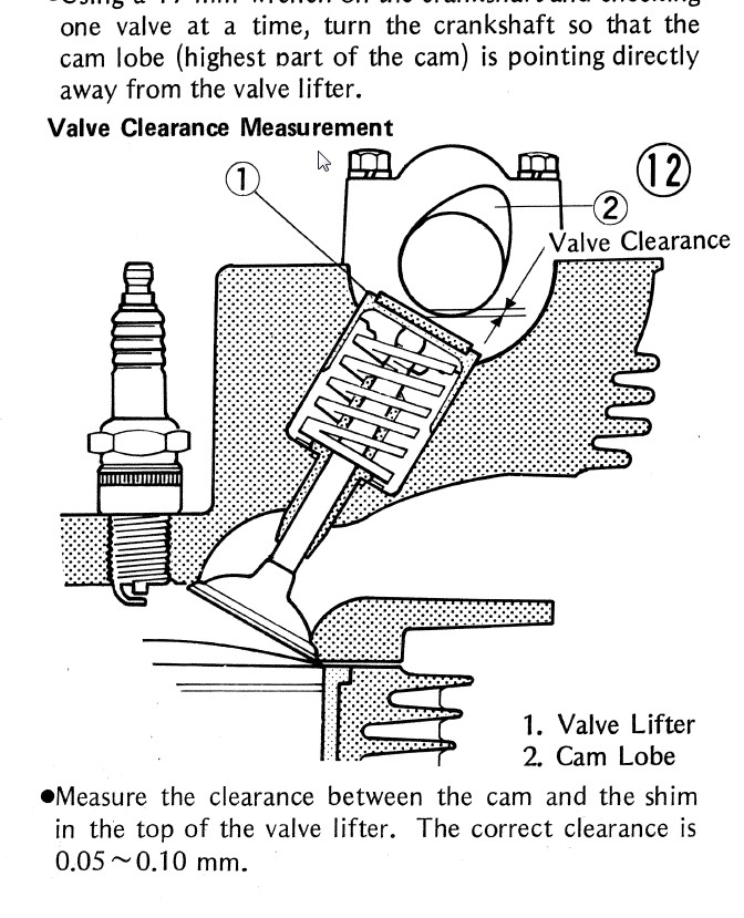

Can anyone tell me if this is the Kawasaki service manual method?
If not,does anyone have the appropriate information handy? I'm looking for a KSM on ebay now..

Re: Valve clearance too tight?? '77 KZ650
15 Dec 2014 16:55
My FSM says to check clearance with the cam lobe pointed directly away from the lifter.
1979 KZ-750 Twin
15 Dec 2014 18:49 - 15 Dec 2014 18:49That may be the spec for the KZ750 twin, but the KZ650 spec is different. Ed
