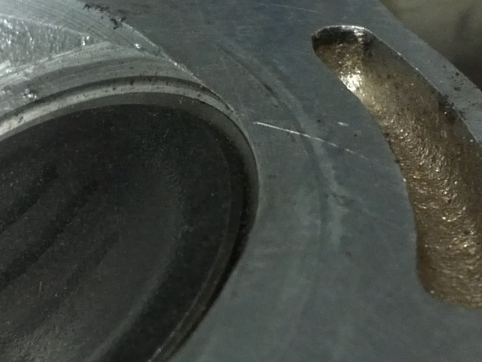

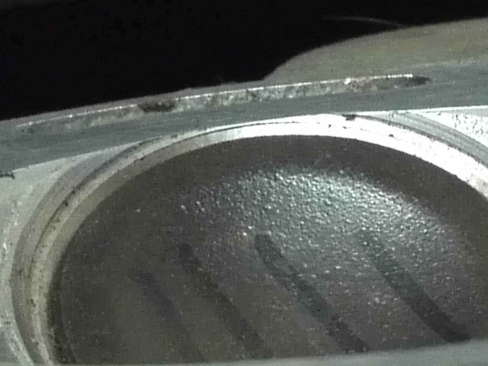

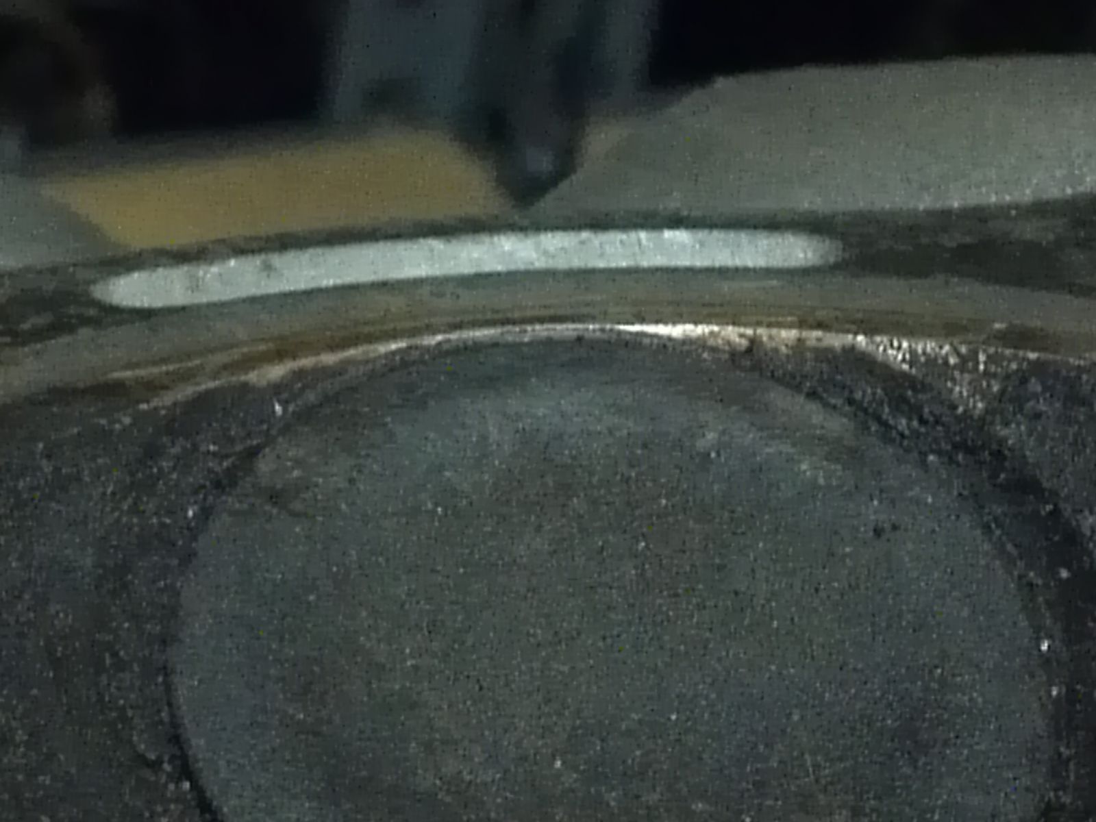

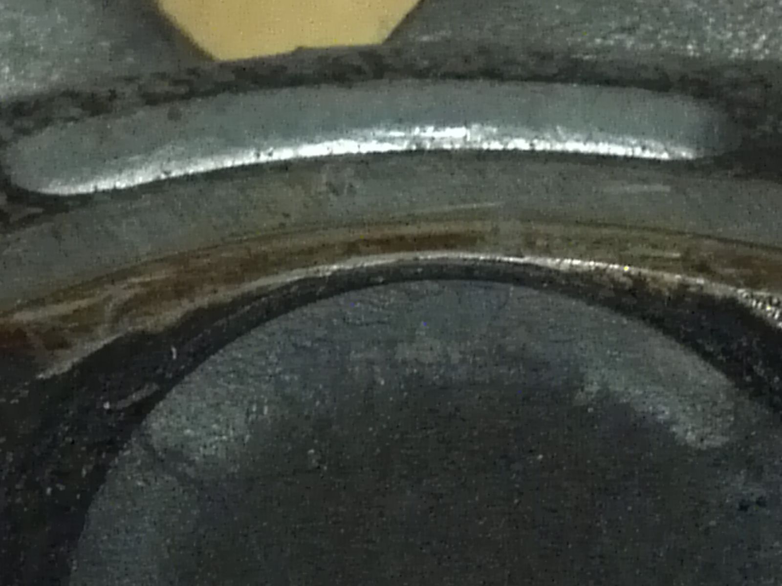

Mill off .020" and you will hit the valve seats on a regular KZ750E head. Does the GPZ head have more spacing between the seats and the deck surface?

21 Dec 2014 10:12 - 21 Dec 2014 10:15Nessism wrote:Tyrell Corp wrote: Interesting tuning info here, note the thinner zephyr 750 head gasket and 0.5mm head skim recommendation.
members.tripod.com/gpz_rider/technical/FAQ2000.htm
First two pics are of a LTD(H), same as an E, silver paint instead of black.
Second two pics are of a Spectre, same as a GPz, again just paint being the difference.

15 Jan 2015 02:29Nessism wrote:Tyrell Corp wrote: Interesting tuning info here, note the thinner zephyr 750 head gasket and 0.5mm head skim recommendation.
Do you have a head you can measure:
kzrider.com/forum/2-engine/596833-cylinder-head-skim-markers
would be reallly interested thanks
