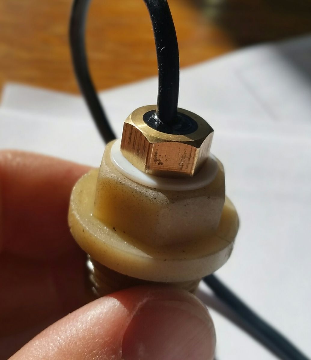

12 Dec 2014 10:03
So I removed the guts to the OEM pressure sensor drilled it out to 5/16" and tapped it for 1/8" BSPP. Here is the finished modification, looks like its stock to me.
The sensor I am using connects to my existing Trail Tech Vapor.
I do not recommend this mod without installing a pressure gauge. I am using the port above the points cover to connect an oil pressure gauge. Knowing you have oil pressure is much more important that know oil temp.
