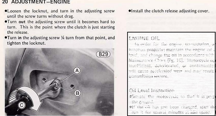

Re: 79 KZ400 Clutch adjustment screw and lock nut
15 Nov 2014 20:45 - 16 Nov 2014 05:01
It looks like it is assembled correctly, tho I'd be tempted to get a couple of cans of brake cleaner and spray away the chain goo.
In the post above, you said you turned the screw all the way clockwise then 1/4 out. That is not correct.
Turn the screw clock wise until it is no longer in contact with the mechanism. Slowly turn it counterclockwise until it touches, then clockwise 1/4 . t seems counterintuitive, but that's how it goes.
