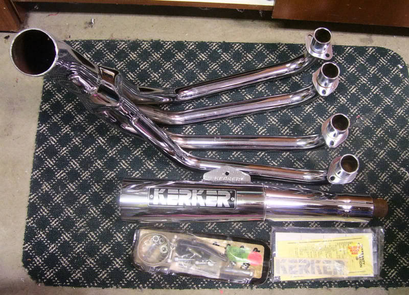

'Best' is subjective, a 4-1 is really a rpm power tune, 4 - 2 - 1 is probably the optinum but the linked 4-2 stock pipes are best for bottom and midrange. I think the original z1 4-4 was as much a styling thing.
I have a couple of vintage kerkers but they are very hard to come by. particularly in the UK.
Unless you are going for the Kerker megaphone or hand-bent Yoshimura period bling $$$, I'd go for a stainless steel exhaust, you could even get a one-off made as a copy. I did that myself and did some calculations to 'tune' the pipe to the motor - it sounds great and works very nicely.
An engineer I spoke to who is in the exhuast business did some R&D consultancy for Honda many years ago, he told me that unless running a highly tuned motor with a long duration cam the dimensions aren't too critical.
