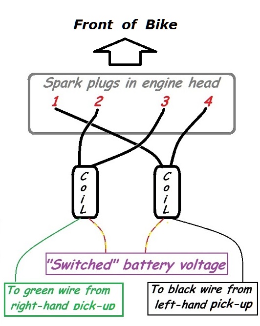

16 Oct 2014 18:15 - 16 Oct 2014 18:27KZBrett wrote: . . . Apparently these new wires have an issue . . . After switching number 1 and 4 wire the gas coming out of the carb switched with it.
A cylinder with decent compression should suck mixture from the carb as normal and push it out the exhaust -- and whether combusting or not combusting is likely unrelated to carb leakage. The carb doesn't know or care whether or not the cylinder is combusting.
If not already done, would assure that the coil with green primary terminal wire is connected to the two inside spark plugs, and that the coil with black primary terminal wire is connected to the two outside spark plugs.
