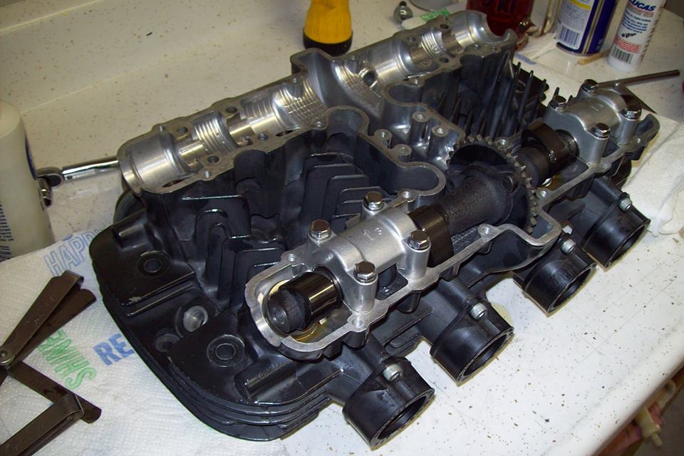

Keeping the cam caps with the head they came off of is a top priority when taking a motor apart. I ALWAYS put the cam caps back on the head as soon as I pulled it off a motor. The method described by zed1015 for finding the correct cam caps is the only surefire way of doing it. I have seen some major dilemmas on motors where the builder mixed up the cam caps. I have seen a few motors that would barely spin over because of super tight cam caps!!!!! Then watch the mechanic panic and go through cam caps after cam caps till he found a set that let the motor turn over normally!!!!!

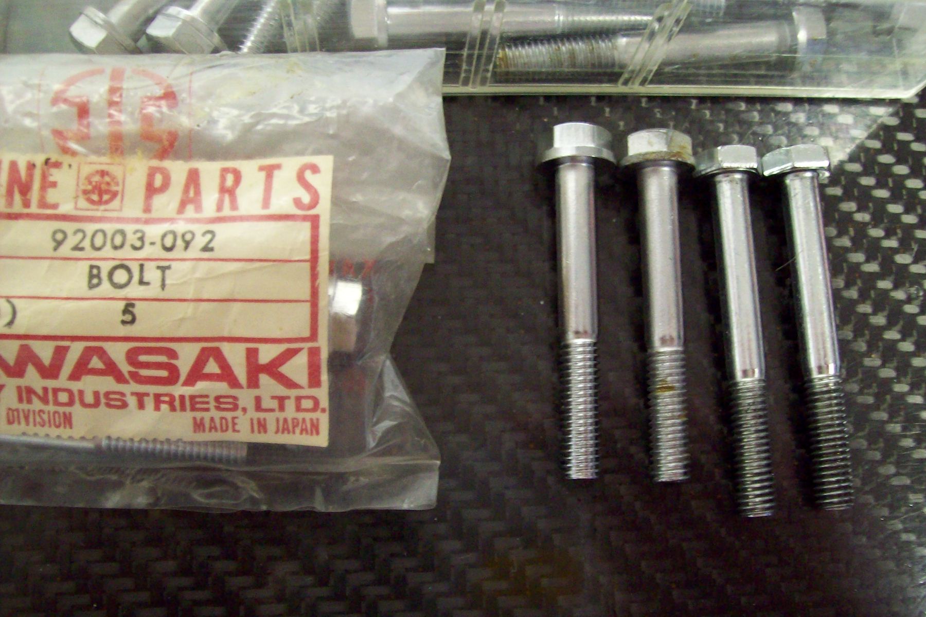

I posted this little trick on how not to strip out the threads for the cam cap bolts on my build thread of when I put my old Superbike back together. Instead of using the standard 6x45 cam cap bolts . I start off with 6X50mm or 6X55mm bolts at first to start to bring down the cam caps. That way you are using a lot more threads on the bolt holes when you first start bringing the cam caps down. When you get within about a 1/8 of an inch from the cam caps touching the head. Replace the longer bolts ONE BY ONE with the standard 6X45mm cam cap bolts. This is a must when you have a motor with cams that have like .410 lift or more!!!!! I have .440 lift cams in my Kz motor right now, and if I use the standard 6X45mm bolts, I would be grabbing only like 2 or 3 threads as I started to bring the cam caps down into place!!! I have NEVER come close to stripping out any of my cam cap bolt threads since I have been putting Kz900/1000 motors together using this method with the longer bolts!!!

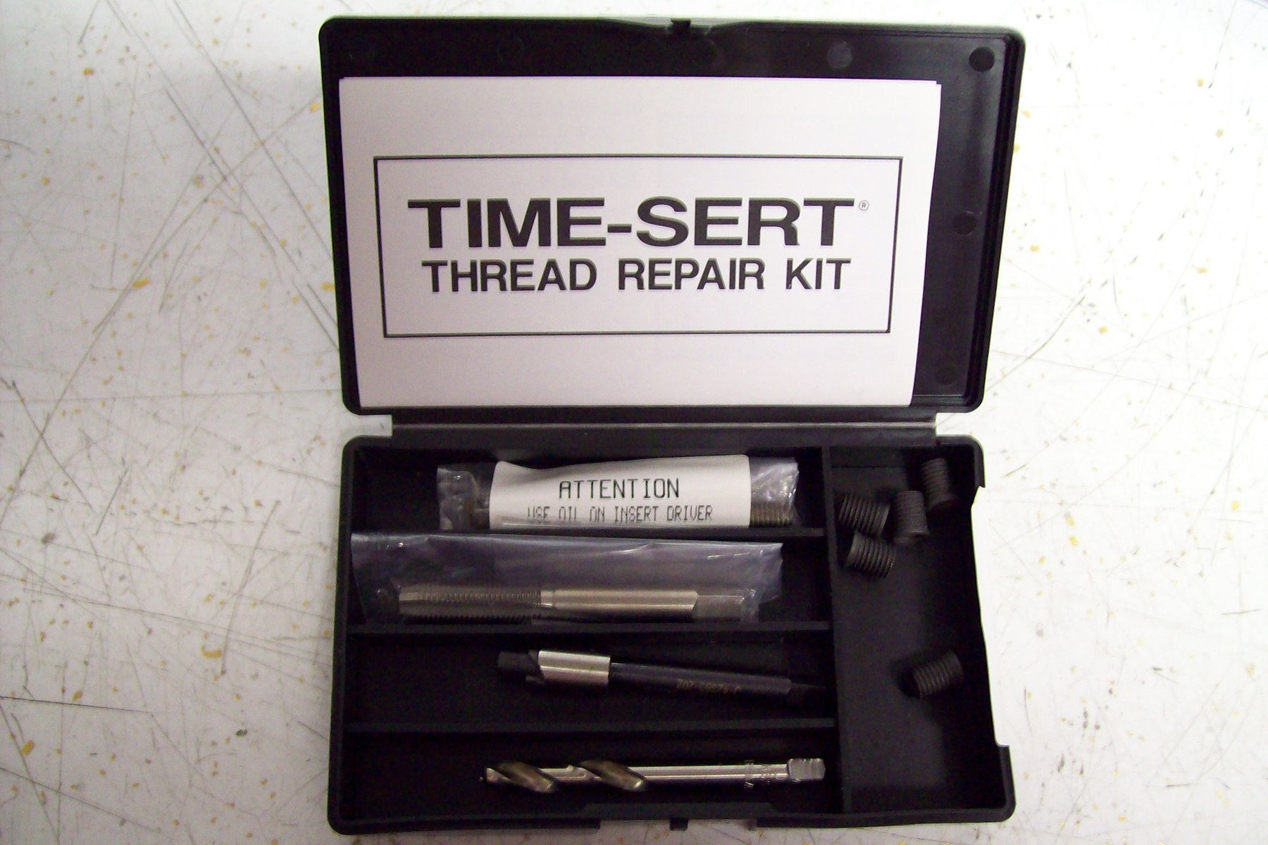

When I do find a head with stripped out threads, the ONLY thing I will use to restore the threads are Time-Serts. It is the only type of repair that works when you have to keep pulling your cams when you do your valve adjustment.

.440 lift intake cam in place on motor.
Here are the longer bolts I use to start to bring down my cam caps next to the standard bolts.

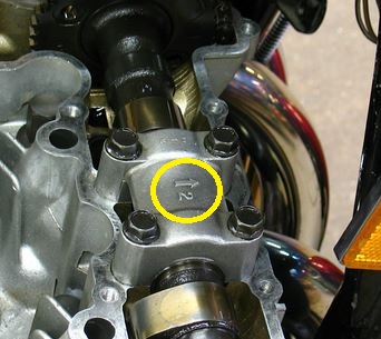

What amazes me is the fact that some folks don't put KZ caps back in the correct spots even though they have the position number cast into them. It would seem like that would make mixing them up impossible, but .................. :laugh: Ed
