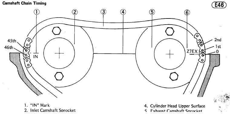

Crank set at T
Intake camshaft has the IN line flush with the head surface (disregard crap gasket. Gonna scrape it off soon)
Exhaust camshaft has the Z7EX line flush with the head surface
From here
To here
Is the 45/46 link and the chain is tensioned.
Am I set to the correct timing?

Looks like mne. Looks good. Hard to make out the marks in your photos but as long as all is like this
and from your description it sounds like it iis then your timing is correct
