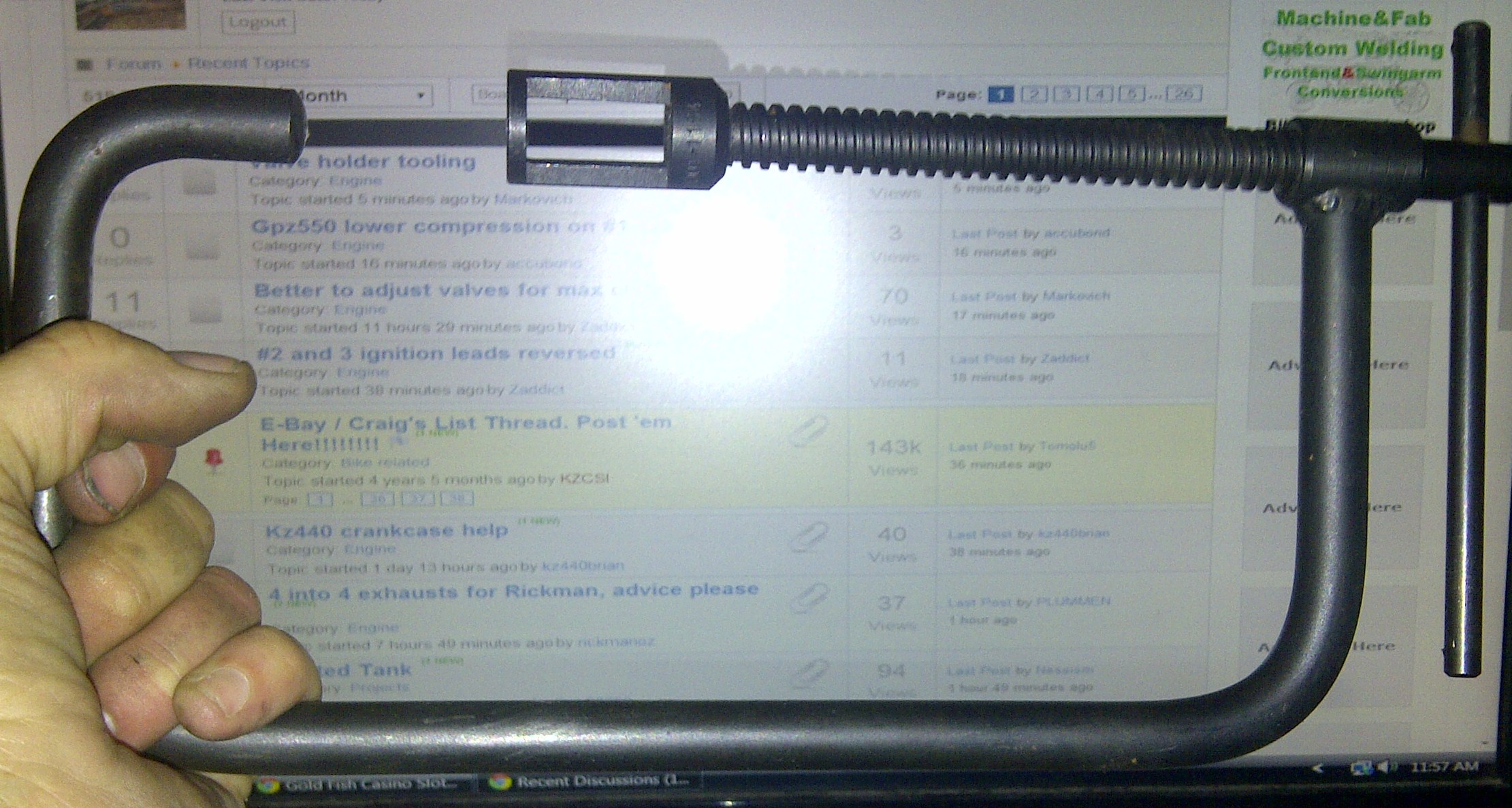

you can do one of these or spend more on the oem type....... :blink:
