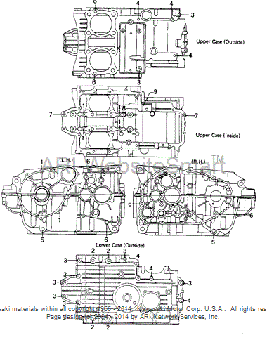

Does anyone know how to get the top and bottom halves of the kz440 crankcase to seperate? I have all bolts removed but can't get them to seperate.

You don't have them all out.

I have double and triple checked that they are all out. When I put a screwdriver in the pry points I can see the seam open slightly, but it doesn't come apart. I have the upper cam, head, and block removed as well as the clutch and starter and oil pump.

Thanks for the help. I kept searching and found the previous owner had sealed them together so well it just wasn't moving. Now it is apart.
