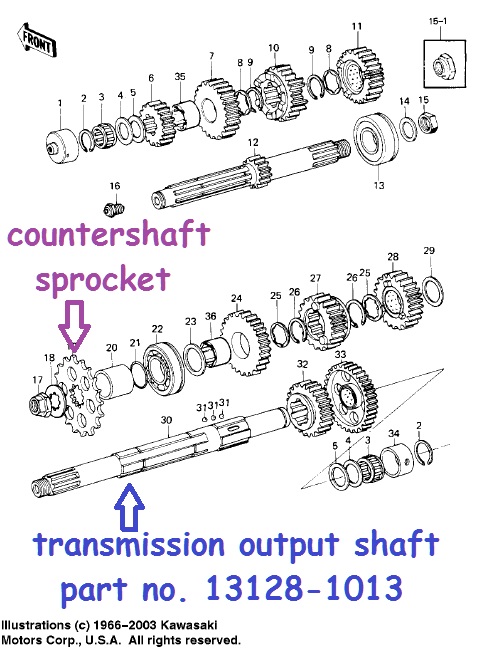

04 Aug 2014 13:51 - 04 Aug 2014 14:07Larger hole is the #21 rubber oil seal that fits over the splined shaft to which the front sprocket attaches.
These diagrams are from kawasaki.com, which includes parts diagrams, part names, part numbers, models sharing same part, availability, etc. Here's a link for help with navigating the site and finding information.
www.kzrider.com/forum/13-bike-related/37...imitstart=0&start=20

04 Aug 2014 19:50DobbinsCMA wrote: Huh. I ordered the kit from Z1 and it didnt include one for it. I looked at the parts diagram and the manual but didnt see which seal it is. Anyone have a part number? I should have saved the seal lol
What "kit?"
Look under "Clutch" in the kawasaki.com diagrams at part 25 to see the o'ring size, part number, etc.
