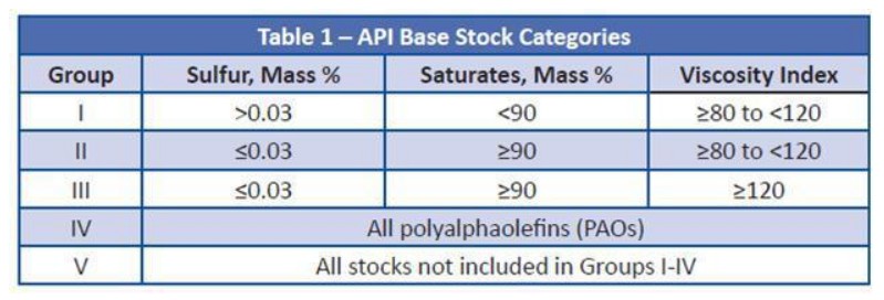

lubeng.wordpress.com/2012/06/19/is-your-...il-really-synthetic/
Is Your Engine Oil Really Synthetic?
Posted on June 19, 2012 by Birju Shah
During our sales meeting, I came across an interesting fact: all the engine oil that is marketed as synthetic is not actually synthetic. A good definition of synthetic oil is “noting or pertaining to compounds formed through a chemical process by human agency, as opposed to those of natural origin.” As most of you know, the American Petroleum Institute (API) ranks base stock in the following categories:
InNorth America, Group 3, 4 and 5 are marketed as synthetic oils even though Group 3 is actually a version of highly processed hydrocarbons (mineral oil).
