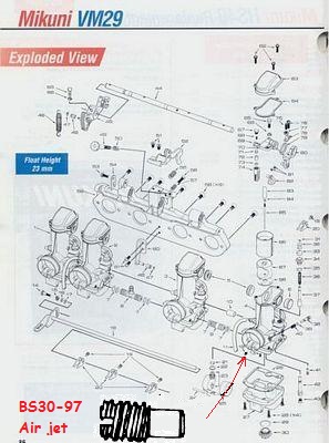

If not already done, would assure the BS30-97 air jet is perfect.
29 smoothies not often seen with accelerator pump ---
