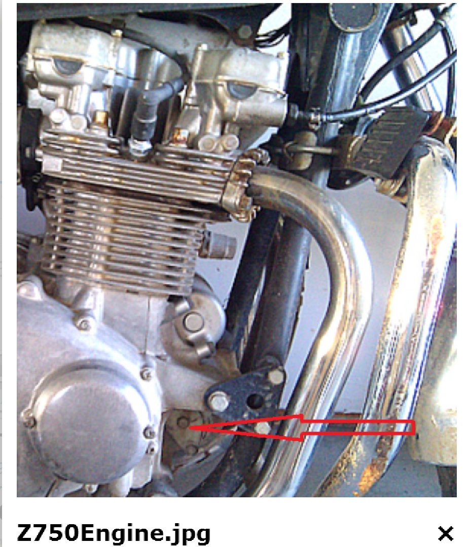

Hi.
Does anyone know what the coverplate in the picture is for? I have an oil leak around it and it looks like it's coming from behind the plate. However, when I take it away, it doesn't seem to be anything behind it, except for the engineblock.
Regards/Janne

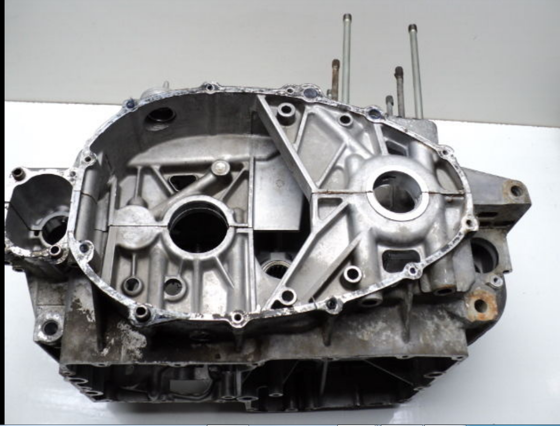

Double check for a plug. The crankcase diagram shows a plug & o-ring along with the plate. The top bolt may thread directly into the plug.
See 3rd photo of this item from blebay. 370695752719

The ebay pic --

I seems to be some kind of blindcap, I found i in the manual. I will check out the oring.
