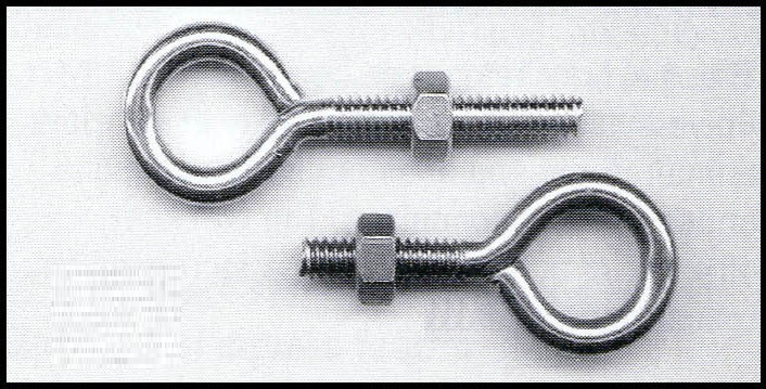

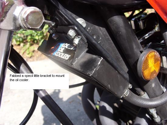

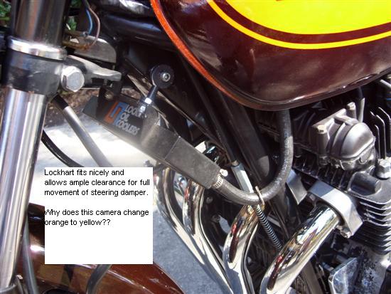

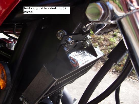

While the original fitting is extra nice when available, a simple but effective alternative method is to attach the Lockhart oil cooler by using two eye bolts (lollipop bolts).
LTD -- attached fabricated plate with cooler attached to the plate.
Z1 -- bolts directly to cooler.

Thanks very much for your reply,,thats an excellent idea,,i feel stupid for not thinking of it,,lol and thank you for the pictures,i saved them in my smart phone,,i very much appreciate your response and brilliant idea
