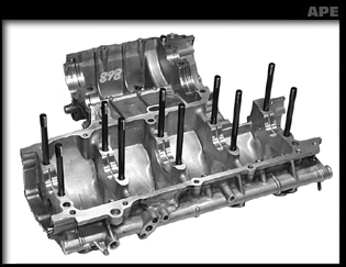

Theyre talking about the big bolts around crankshaft area :)

Im referring to the 8mm bolts that hold the area around the crankshaft together that ape sells stud kits for.
:)And yes,its definitely inch lbs of torque.

awesome ur guys are the best, and plummen yes those are the bolts i was talking about as well, the bolts that go over the crankshaft, aka crankshaft bolts. i guess they people call em different things

Those are main bearing studs (case studs). Bolts have threads only on one end; stud are threaded on both ends. Ed

I didnt have a picture handy of a set of cases with with the bolts, thats why I used the ape picture instead.
