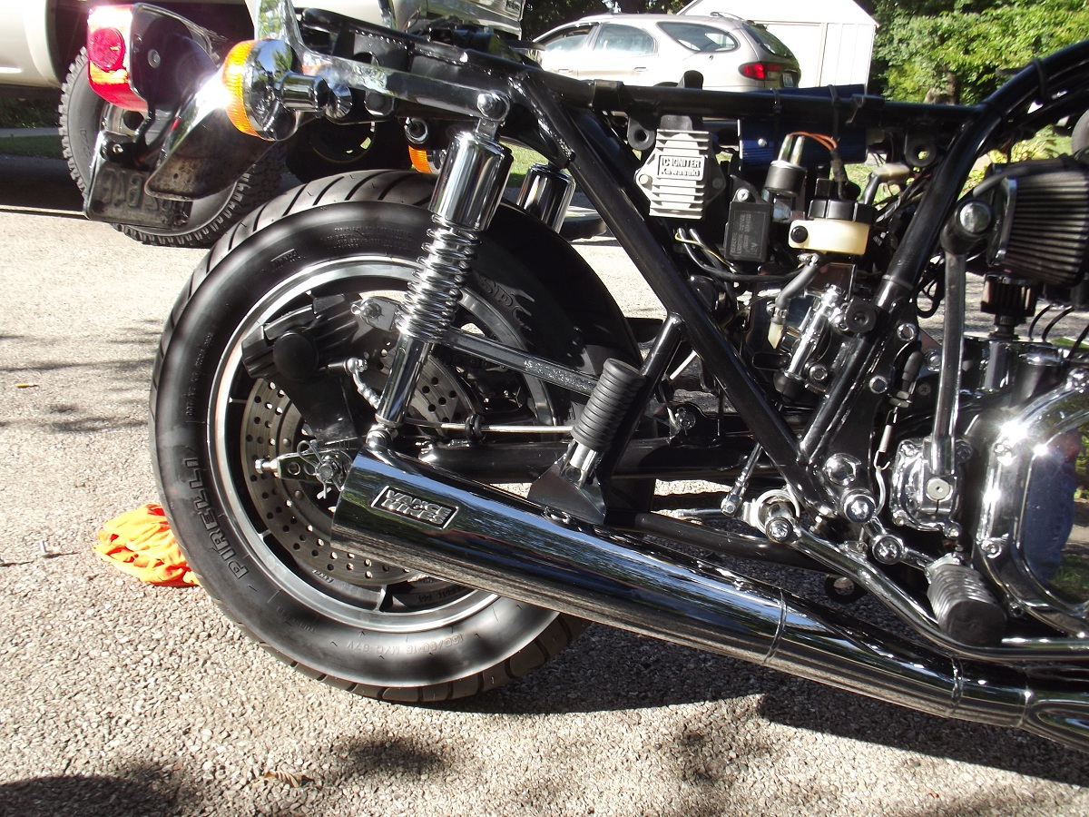

Mystery here, took my KZ 900 A4 apart in 1999 and am just now wrapping up the reassembly. Lots of new everything, my business kept me too busy and a couple other bikes. Anyway, I cannot find this part in my Parts Book or any of three shop manuals, including the factory manual. I know it came off the bike, and at the risk of being a complete geek, I've decided to ask. Anyone have a name/part number for this "master cylinder" and fluid cup? :pinch:

that part not for 900 A4 ????????????????????
pretty sure its to a Z1r
master cylinder # 43015-1041
the cup or reservoir is anyone's guess
www.partzilla.com/parts/detail/kawasaki/KP-43015-1041.html
www.cmsnl.com/kawasaki-1980-kz1000-d3-z1...t/66462.html#results
www.cmsnl.com/kawasaki-1980-kz1000-d3-z1...t/66479.html#results

+1, After market M/C. Or used from another bike. The reservoir is attached to the master cylinder body / bore on an KZ900 A4. I think the best option is to get a new eBay M/C so you won't have to worry about rebuilding it and a lot even come with a spare rebuild kit. I bought one for $29.00 shipped and works great. Cheaper than buying a rebuild kit for an original KZ900 M/C.
Here is a picture of an original M/C: drive.google.com/file/d/0BxeuyU_DUv0iXzY...SHM/edit?usp=sharing
Here is what I replaced it with:

Looks like an 80 1000 ltd style rear master cylinder to me anyway.

Was your bike converted to a rear disc brake? The remote reservoir looks like it's what's used on a rear MC.
