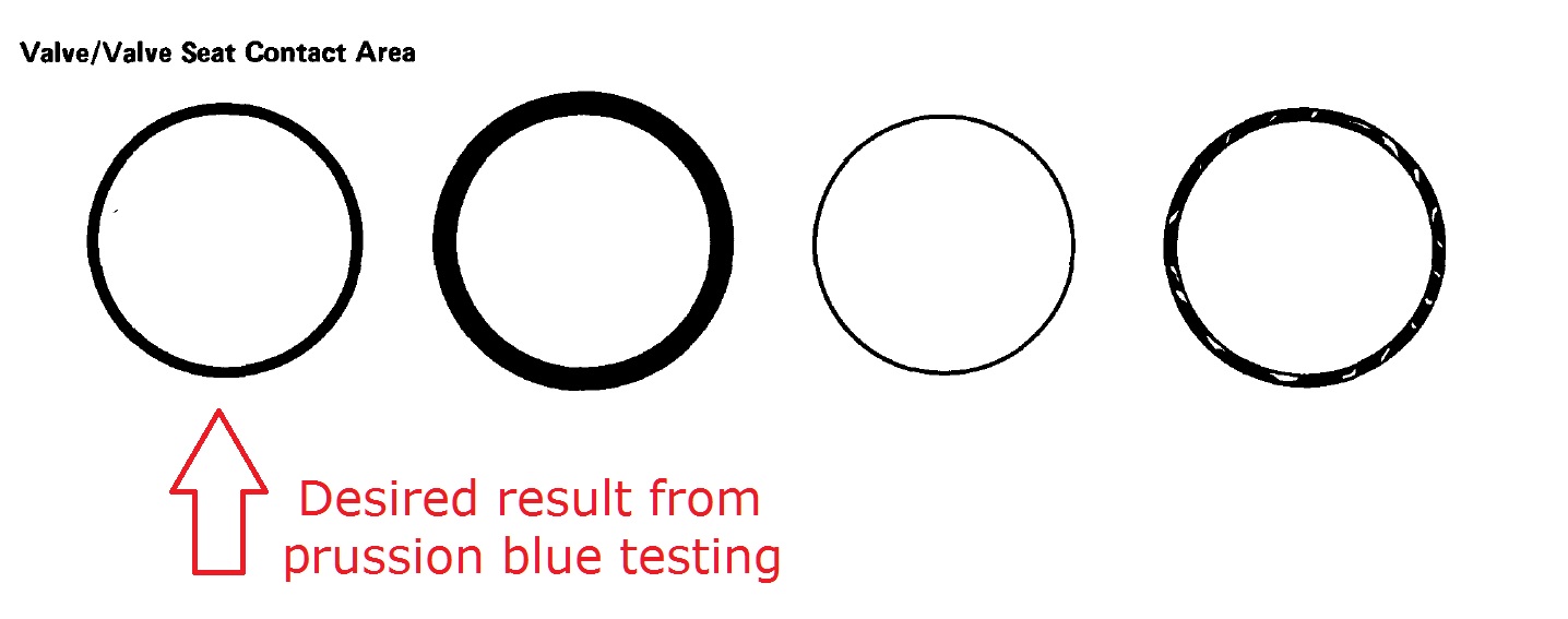

Did you use prussian blue to check a perfect valve seat?

As you lap the valve, you should see a margin form in the middle of the 45.
At first it will appear thin and inconsistent. With some more lapping and checking,
it will widen until it turns into a distinct band consistant all the way around. A thin margin
on one side and wide the other is a valve seat needing cut. If the valve doesn't seal after
much lapping it will develop a receiver groove and need to be cut. At the point of perfect
margin forming you can test ithe seal by inserting the valve., filling the chamber with water,
hold down the valve and shoot air into the intake, You should see tiny bubbles and few, if
the margin was close. A little more lapping and the valve should not leak ANY bubbles.
A very slight amount removed from the valve or seat makes quick work of lapping in
quickly and completely. Valve clearance doesn't tend to change ounce its shimmed ,
after lapping. If your using fine it can take a while to cut in, I use a coarser grit and it
can take a while as well, If the valve has nitride surface it would take all day with fine grit.
When the valve and seat are cut generally nice to excellent, the valve lap and seal is
quick, NO more dreaded bubbles.
