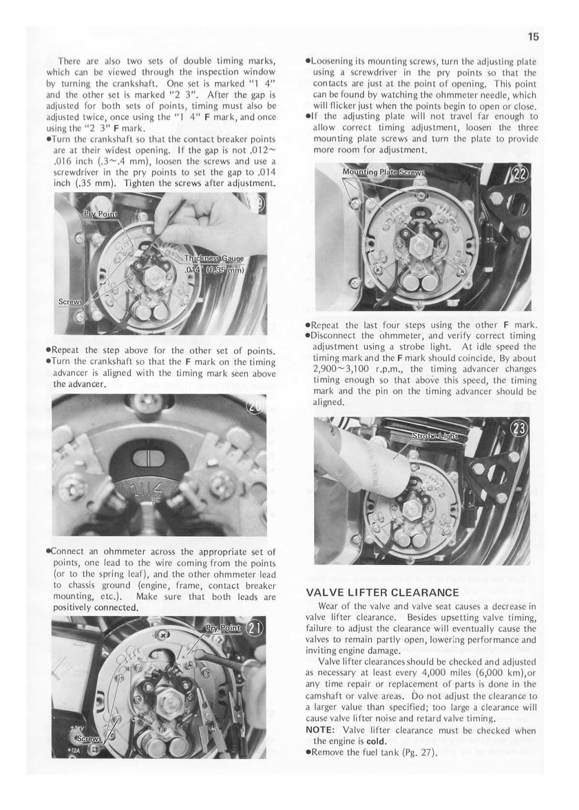

1977 Kz1000, with points. Also, if anybody has info on setting up the points as well.

Here are the sections in the z1 manual.
