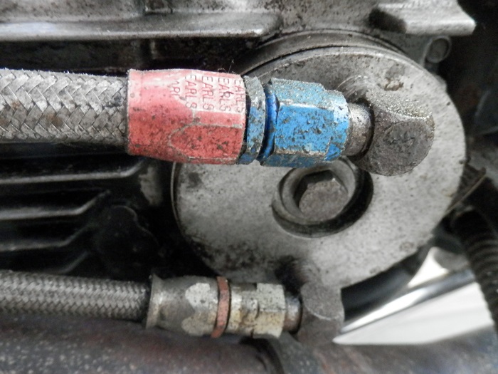

Btw, could take some good pictures of the filter adapter plate? Many of the k650 users would appreciate it.
Thanks!

I'll add a photo later for undiablo

Ok here's the picture of the plate which connects the hoses to the motor, As far as I can tell it just replaces the stock oil filter cover and I am pretty sure it uses the existing oil filter bolt. Checking parts diagrams at kawasaki.com it looks like the 750/4 shares the same oil filter cover with a long list of 650s and 1000 and a few more models.
Lots of road dirt underneath eh

Dirt means you actually use the bike! The old KZs are ment to keep rolling! Thanks for the pic, interesting plate adapter...

That plate/ cover is more like a cup. The side wall is about 2 cm deep whereas the stock cover is almost flat. You will notice that the bolt is recessed. Its a bit messy changing the filter but install would be simple.
