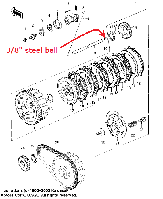

Is the ball bearing still there? And is the pushrod seated correctly?

steel ball and plunger are all there. took clutch basket off to make sure everything on that side was good. I'm thinking there is something missing on the linkage where clutch cable connects to...and it's not quite reaching the tip of the pushrod...
my question is...what is #5 in the diagram above? I'm clearing missing whatever that is.

03 Jun 2014 20:06 - 03 Jun 2014 20:5579Bobber wrote: steel ball and plunger are all there. took clutch basket off to make sure everything on that side was good. I'm thinking there is something missing on the linkage where clutch cable connects to...and it's not quite reaching the tip of the pushrod...
Just guessing, but #5 might possibly be clutch release oil seal part number 92049-1003 that's shared on some 67 Kawasaki models.
Would confirm this by checking at the kawasaki.com website link earlier provided.
