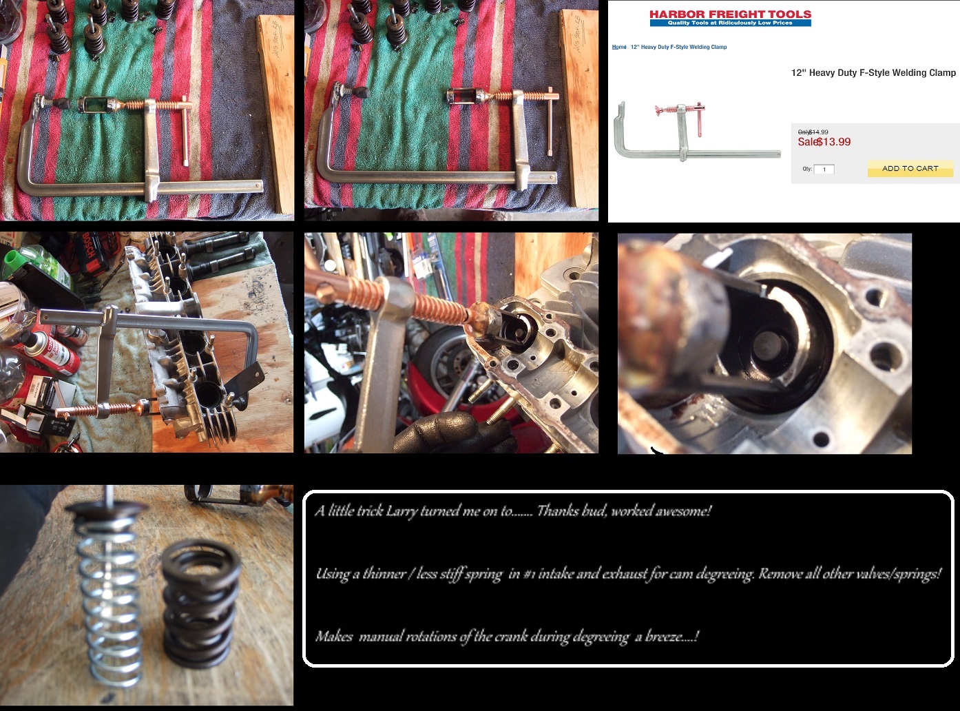

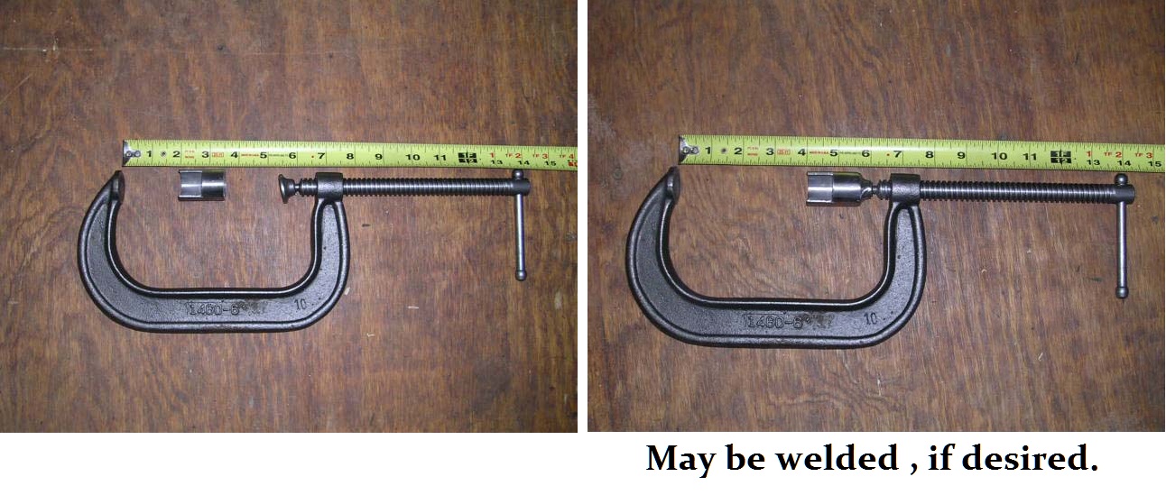

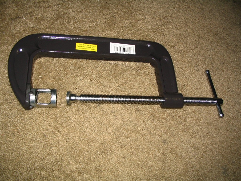

What I did for my 750 twin was to make one myself. I took an old socket and used a dremel to cut out about 3/8 of the metal around the hub. I took an old c-clamp and superglued the socket to the screw end of the clamp. it works pretty well but you need some really good needle nose to get in there and put in/pull out the retainers. The whole device works well and it was only about ten bucks worth of parts when the one sold at Z1 is about $120.

Yeah exactly like above ^^

It has been a while since I have been back to this post. Thank you for all of the help and suggestions. I ended up using a ½” drive 19mm socket that I cut 2 access holes that allowed me to get to the retainer clips on the valves…aided by a bar clamp to do the compressing. Worked great!!! I have the old 650 back up and running better than ever…after a valve adjustment and carb recynch.
