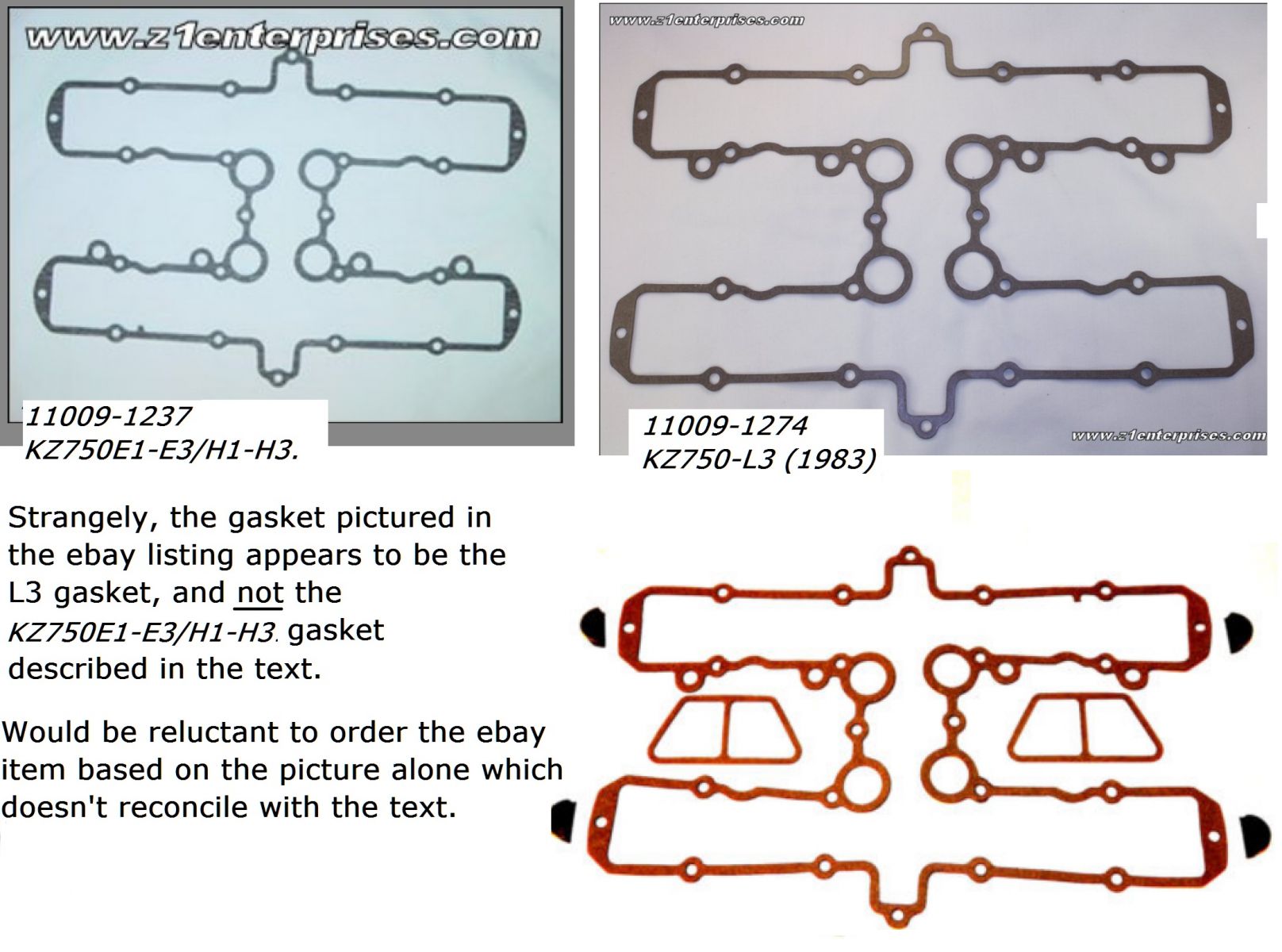

kawasaki.com shows the same valve cover gasket part number 11009-1274 for KZ750-L3 (1983), with or without the reed valves.
Listed at Z1 Enterprises:
Click here > www.z1enterprises.com/ItemDetails.aspx?i...X750&item=11060-1603

As the ebay seller has good positive feedback, you might consider inquiring as to why the wrong picture is apparently shown in the ad.
