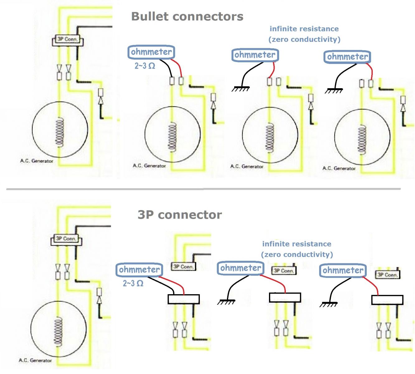

Would it be feasible to do the ohm tests without removing the cover, assuming that either the bullet connectors or the 3P connector isn't hidden underneath the cover?
- loudhvx
- Posts: 10864
- Thanks: 1619
Re: stator replacement
04 May 2014 07:33
Yes, check under the cover first. It may just be broken wires, and not a bad stator. You may be able to splice them if there is enough there to work with.
