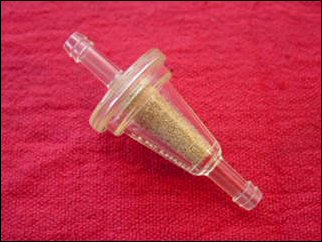

04 May 2014 05:42Janz3n wrote: ... looks like he put a new fuel filter on already. did these bikes come with fuel filters stock? wondering if the PO didnt have one on at all....
Likely came stock with only a fuel filter screen that's part of the petcock.
A good aftermarket in-line fuel filter is highly recommended.
Here's a sample of the various types available:

the bike has a filter similar to that one on it now that the guy put on before selling.
