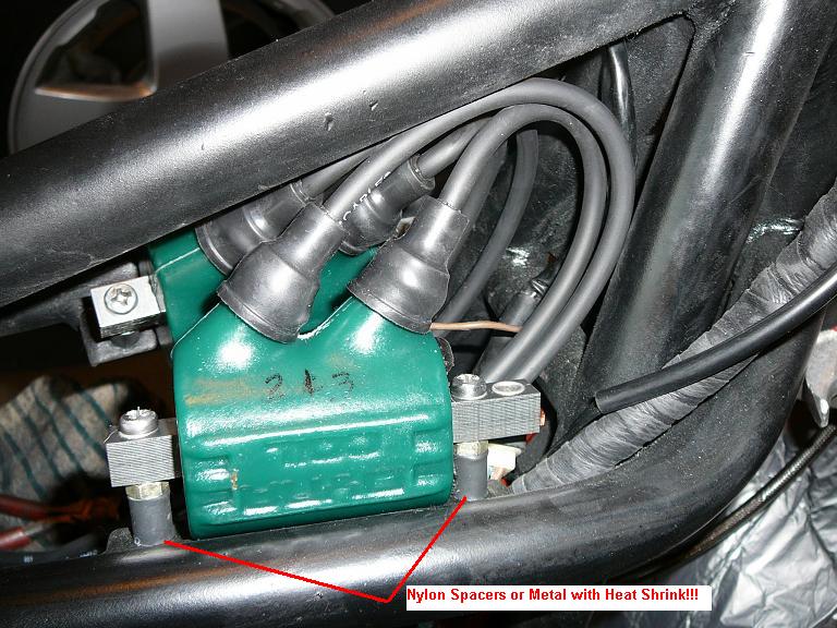

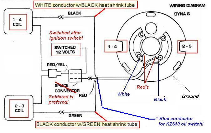

Re: Changing out points for Dyna-S on 1978 KZ-650B2
26 Apr 2014 08:45 - 26 Apr 2014 08:47
1976 KZ900-A4
MTC 1075cc.
Head: P&P via Larry Cavanaugh
ZX636 suspension
MIKUNI, RS-34'S...
Kerker 4-1, 1.5" comp baffle.
Dyna-S E.I.
Earls 10 row Oil Cooler
Phoenix, Az
MTC 1075cc.
ZX636 suspension
MIKUNI, RS-34'S...
Dyna-S E.I.
Phoenix, Az
Last edit: 26 Apr 2014 08:47 by Old Man Rock.
The following user(s) said Thank You: OLKZ, Tomolu5
- OLKZ
- Posts: 60
28 Apr 2014 07:31
Thank you thank you thank you for these nice clear pix!

Be sure to use the shrink rap or tape on the terminals like old man rock shows so you don't short nothing and after setting the timing check the over all advanced timing with a light.
My timing at idle needs to be maybe one line or slightly more clock wise to get full advance at 3,500 to 4,000. With it right on the money at idle its at least 2 or 3 lines away from the advance marks.
Also If you ever crank the motor over with the plug wires off say to check compression be sure to un hook the power to the ignition and coils. I think I might have blown a module that way and have been warned by others on here to do this.
