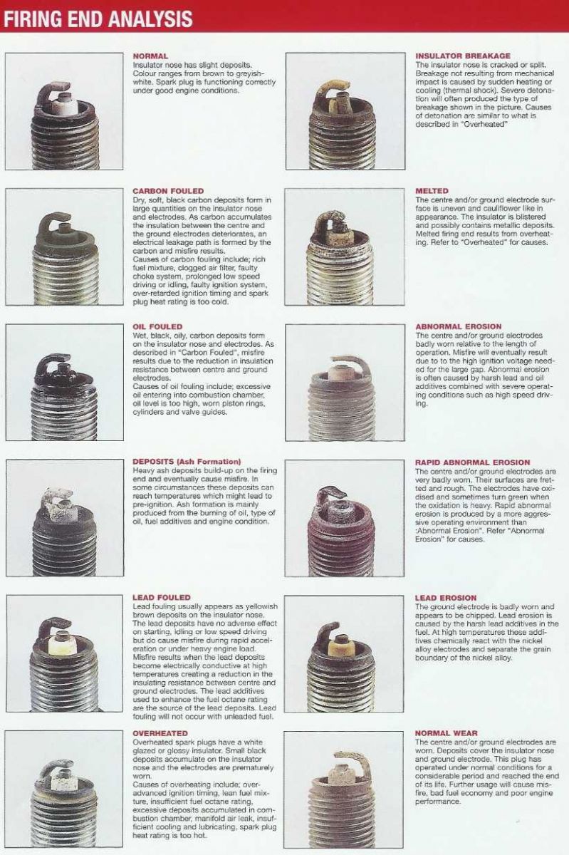

One of my most prized possessions is my vintage Champion Spark Plug reading tool.
Reading a plug tells you everything. If you know what you are looking for.
