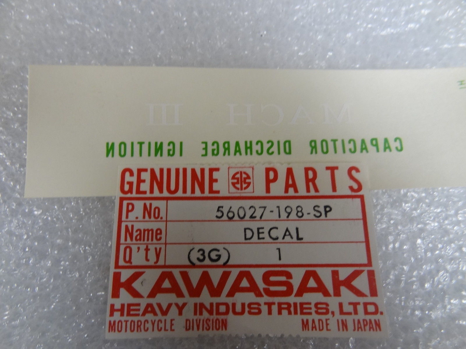

...Capacitor is also correct, Ed. Condenser is just a more common term, especially here in the US. I think the Japanese just like using the term, capacitor.
...A la the old '69 Mach III.
