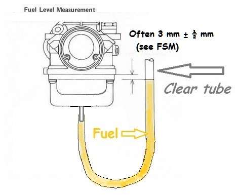

- Posts: 18568
- Thanks: 2101
Re: KZ750L RPM Spike without Throttle input
13 Apr 2014 19:41
The clear tube test must be used from the DRAIN function, and NOT from the "overflow" function.
Some carb designs have nipple from bottom of float bowl that serves dual purposes as both over-flow and drain. Clear tube may be simply attached onto the nipple (in "drain" mode, which generally means slightly loosened drain screw, whereas tight drain screw is "overflow" mode).
Where the carb has only the overflow circuit exiting through the nipple from bottom of float bowl, do NOT use the nipple for the clear tube test. Instead, use the hole where the drain screw threads into, as depicted in the follow illustration:
- Posts: 18568
- Thanks: 2101
13 Apr 2014 19:50
A clear plastic tube of the "correct" outside diameter may be self-threaded into the drain screw hole.
Properly done, it won't leak at all. However, minimal leakage won't invalidate the test.
The upside down dry measured float height is a default position to be fine tuned later when setting the actual fuel level via the clear tube method.
Because correct fuel level is the important objective, regardless of whatever float height is needed to achieve the correct fuel level.

- Posts: 18568
- Thanks: 2101
13 Apr 2014 20:08
Would always first perform the clear tube test BEFORE adjusting the float height (bending the tang), because the fuel level may already be pretty close to spec (even though the measured default float height might seem out of range).
Ideally, the measured default float height is supposed to produce a fuel level that's within specs. But often this doesn't happen.

13 Apr 2014 20:18
No, the carb holder screws didn't come with washers. The part they tighten to the cylinder head has metal imbedded in it; it isn't just rubber even though it looks like that.
Regarding the fuel level. As stated, use the clear tube method. It is the only way to accurately measure the level of the fuel in each carb bowl. The floats may not all have the exact same buoyancy, so setting float levels may only get you in the general ball park. When the carbs are off the bike, you can use the old carb holders mounted to a piece of plywood and set level to hold the carbs and do the clear tube test. Ed
