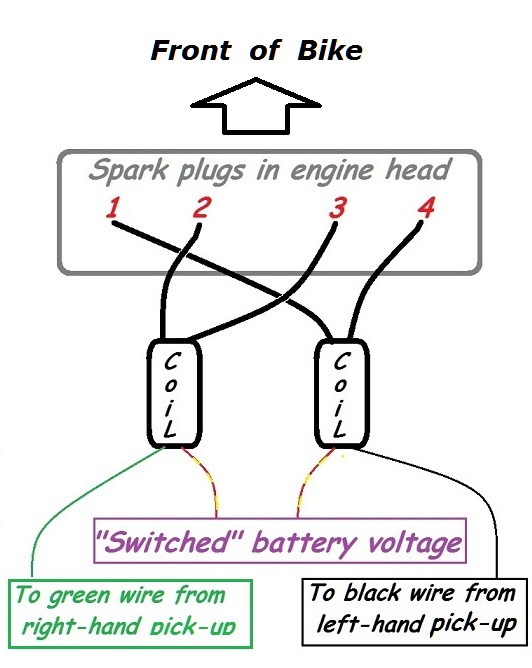

# 3 and # 4 cylinders are working fine. Make sure the other spark plug wire from the coil that's hooked to the #3 cylinder spark plug is hooked to the #2 cylinder spark plug, and that the other spark plug wire from the coil that's hooked to the #4 cylinder spark plug is hooked to the #1 cylinder spark plug. I suspect you have already done this, but it wouldn't hurt to double check because if those 2 wires are attached to the wrong plugs you will experience the symptoms you describe. Ed

Regardless of wire colors from the Dyna-S to the coils, be sure the left-hand (9 o'clock) Dyna-S module connects to whichever ignition coil has plug wires attached to the two outside spark plugs #1 and #4.
And would also spray starting fluid into #1 and #2 carb air intakes to determine whether combustion then occurs in #1 and #2 cylinders.
Here's a lesson I should have learned long ago: ALWAYS DOUBLE CHECK.
My 1-4 coil was connected to 2-4, and my 2-3 coil was connected to 1-3. Makes sense why 1 and 2 weren't firing. Thank you for this post that made me double check. I switched them and it fired right up. All four headers were blazing hot within a few minutes so it's just on to tune the carbs.

16 Apr 2014 21:51 - 16 Apr 2014 21:54loudhvx wrote: Is it possible you just have the spark plug wires on the wrong plugs?
loudhvx wrote: As Ed mentioned, one coil fires the # 2 and #3 plugs, while the other coil fires the #1 and #4.
The coil firing #1 and #4 will have a black wire.
The coil firing #2 and #3 will have a green wire.
