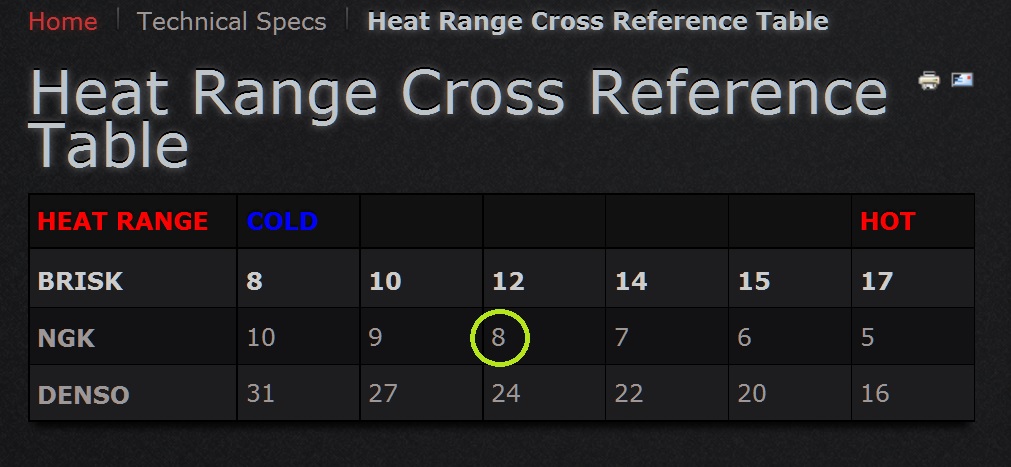

With regard only to heat range -- and not the other physical dimensions -- if the Brisk conversion chart is accurate, an NGK 8 would be replaced with Brisk 12 and not Brisk 15 which is way too hot and apt to burn a hole in the piston.
