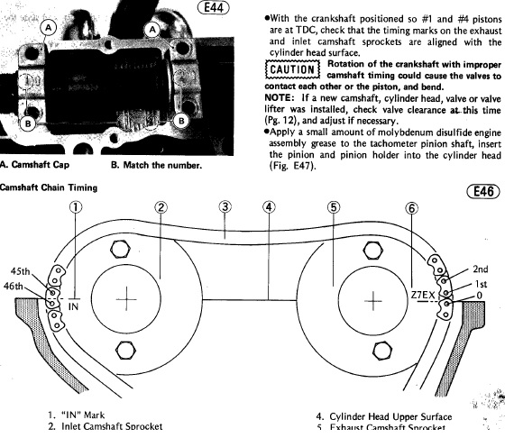

Chain tensioner-actually I rotated the crankshaft after I put chain tensioner and took off valve cover to check timing. Everything seems to be fine there. When "T" mark appears this is how camshaft sits:

The picture below is from the manual and if this is what you are seeing with the correct pin count etc when the T 1 4 mark appears in the window then you should be ok. How is the compression ? No bent valves I hope.
If you still have the cover off you should check the valve clearances as Nessism suggested.
The timing advancer is behind the pickup plate in your second picture and it is the thingy that has the T 1 4 mark on it. To get at it you need to take off the pickup plate. Remove the screws at 12, 4 and 8 o clock in your second picture to remove the plate with the pickup coils and you can see what needs to be lubed as the advancer turns in behind.
